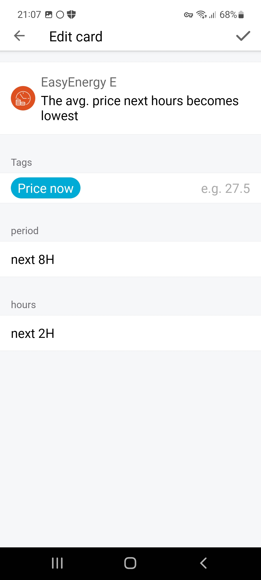

One thing that I would like to be able to do with it, is to identify when the cheapest consecutive x hours are. “The price becomes lowest x hours in the period hours before time”… This would allow me to schedule something like the dishwasher at the true cheapest part of the night. If i was to use the cheapest single hour as a trigger, but it runs for two hours, then I would not necesserily get the best price. likewise, if I use “The price becomes one of number lowest in the period hours before time” then this does not guarantee that the two cheapest hours are next to eachother.
example:
23:00-00:00 - €2
00:00-01:00 - €5
01:00-02:00 - €3
02:00-03-00 - €1
03:00-04:00 - €6
Here, as far as I can work out, withthe triggers available and a 2 hour load at 1kw contant, the price paid would be €7. because the cheapest hour trigger would cause consumption also in the most expensive hour of the example. Likewise, if i was to trigger on the cheapest two hours… well, that’s not how dishwashers work, you can’t just pause like that, but it would presumable trigger on the €2 price, also resulting in a €7 cost.
The actual cheapest consecutive 2 hours would cost €4 starting at 01:00
I hope i expressed my wish clearly. I also understand that perhaps I missed something and there is already a way to achieve this.
Your use case is what I use myself and have already implemented. The trigger card is called ‘avg price next hours becomes lowest’. It calculates the best consecutive hours. You can choose the best hours for today or for the next 8 hours.
When selecting the next 8 hours it will be a rolling condition. This means that when prices keep going down it will never be triggered. So I might also implement the same function but with a finite end time.
Ahh perfect! Yes this is exactly what i’m asking for! I think for most situations it will work out well enough as implemented. But yes, I see that a finite time could be useful for when something must be done by a certain time at the latest.

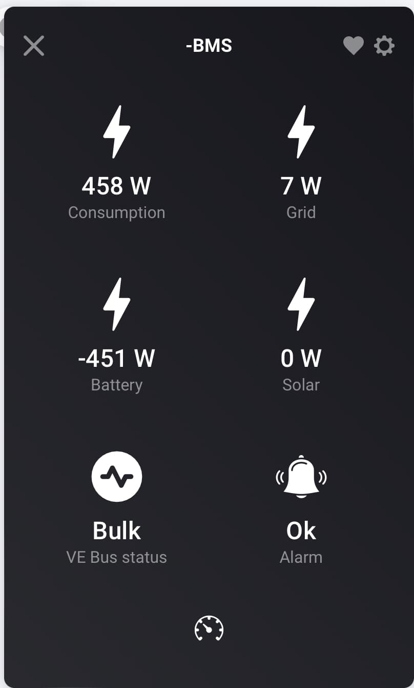

Trying to keep a track of energy consumption and grid energy.
I have created a PBTH device from the Battery Management System.
But I cannot work out how to get PBTH to use Grid or Consumption, I can’t tell what it is using right now.
Given these reading are from an inline meter before the main consumer unit, but after smart meter, they are authorative readings.
I would like to get a summary of daily Consumption and daily Grid so I can track usage and costs.
Any pointers would be appreciated
What app are you using for the BMS? It has multiple Watt meters. PBTH will use the meter that is called measure_power in the source code. So maybe the 0.0287 already corresponds to either consumption or grid.
In any case, if you want to track multiple Watt meters from the same BMS device, you need to make a virtual devices from each of the single values you want to track. You can probably use the GROUP app for that. You then start summarizing that virtual device with PBTH.

Victron Multiplus/Cerbo GX BMS
I’ll search forum for creation of virtual devices.
