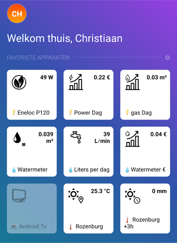

ok yes it is a simple calculation. Still, I prefer a tab on my home screen with the liters per day.
It’s just for looks.
Do I have to calculate it first to save it in the logic card and then send it to virtual button? that virtual app doesn’t have that capacity either. Only Liters per hour.
Probably in the advanced setting of the powerplug of the fridge.

Only that indication is not correct, it is not L per hour. But I can’t choose any other capacity that comes closer.
Maybe your forum members know that?
