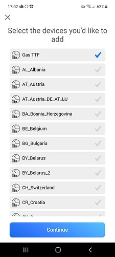

Gas TTF is not loading? I also can’t save settings.

What do you mean by not loading? Can you elaborate on what you do, and what then fails?
What settings are you changing, and how do you know it fails? Do you get an error message?
Pls send a diagnostics report

Weirdly now I can save :-S
TTF not loading:

The TTF Gas price is not on the list yet, has it been removed?
You need the test version. Or wait till it is pushed to stable.
Pls send app diagnostics report. Not sure what is going on there.
I have the test version, but no price as well.
That is so weird that you are not getting gas prices. I just deleted and added gas pricing again. For me it all works good! I wonder if the data source I am using is checking the origin IP. I’m using FrankEnergy as data source, a NL company, and my Homey has a NL IP address. Could it be that your Homey is registered under a non-NL IP address?
