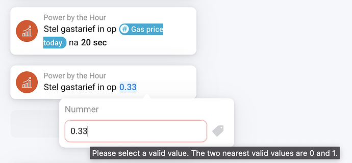

I noticed that I couldn’t update the gas price via a flow. Does it only accept integers?
Pls send a diagnostic report
I think I found out why. I need to add the device setting for Gas and Water to enable update via flow. Will incorporate that in a next release. Thx for reporting!
edit: should be fixed in v4.1.3 Power by the Hour App for Homey | Homey

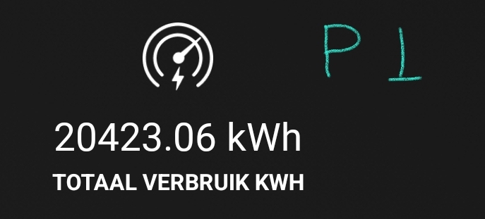

There are many drivers in the Homewizzard app. But I think the driver @Steven_Petein is referring to is the Energy (P1 dongle). That driver has a number of energy capabilities:
I see the T1 and T2 ones. Those can not be used at the moment by PBTH. But I also see “meter_power”. And that is the default used by PBTH as aggregated kWh meter. But why is this meter not giving the aggregated T1 and T2 meters?
@Jeroen_Tebbens can you shed a light on this?
Screenshot_20220304-204240_Homey
Screenshot_20220304-204124_Homey
That “default” meter_power is used as aggregate with deduction of solar production like this.
