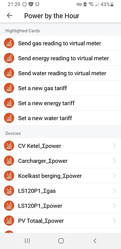

Testing V4.0.1: When creating the flow to update the virtual device, I am unable to select the virtual device… No matter what I do :confused:
Am I doing it wrong?
Mmh. Need to check if I broke this in the last update…
Edit: everything is working fine for me. Are you using the correct procedure? @Joenoo
  1. Add the virtual meter
  2. Create a flow with this action card 'send reading to virtual meter"
  3. Select the virtual device you created
Well I guess I must be doing something wrong. Here is what I do:
  1. Create the virtual device:
  1. Create the flow to update the virtual device:
  2. Unfortunately on both the mobile app and the web app I cannot select the virtual device.
You are not creating the virtual device that can be updated with a flow. The bottom one ‘VIRTUAL_METER_POWER’ is the virtual device.
You are adding Greenwave Powernode that will be automatically updated from the Watts value. (At least that is what the settings are saying). No need to update anything via a flow.
Ah right, it is indeed updating without a flow.
Thanks! Awesome app :smile:
