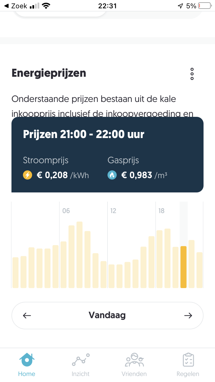

See attached images. The cheaper one is just the bare price, the other one is with BTW and margin.
So the markup is 0.7 cents per kWh and 21% VAT. Is that in line with what your contract says?
Based on that your price at 23.00 should be 0.1779 euro/kWh:
I don’t have a contract with specified prices.
All prices are dynamic hourly or daily. I pay €5 per month service costs.
For taxes see image below.
The price today between 23-24h is €0,178 (rounded)
