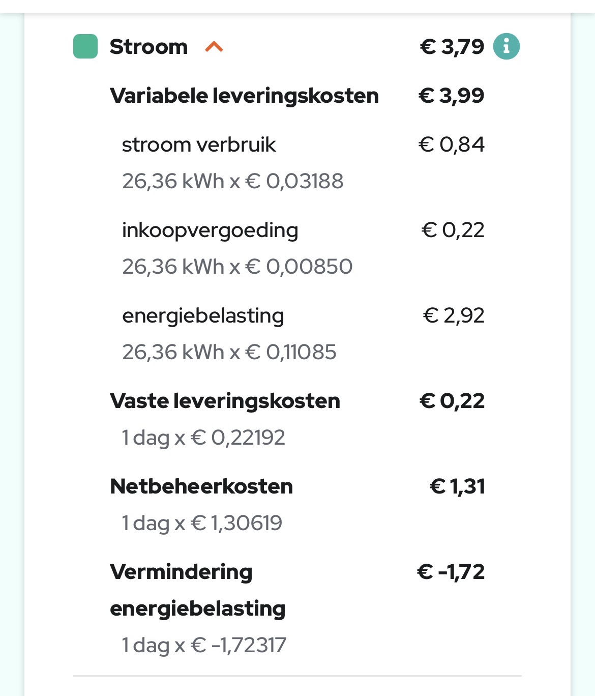

Example day: ‘kWh per day’ = 21,86 kWh. This is correct and same is reported both in Homey Energy tab and my energy supplier (see screenshot Powerpeers: 26,36 - 4,5 =21,86).
Calculated ‘Money prev day’ PBTH: € 3,26. Energy supplier reported € 3,37 (3,99 - 0,62, see screenshots). Difference € 0,11 (this day difference was limited, other days difference is more substantial).
I found several other discrepanties in ‘money calculations’ (both electricity and gas) which I can’t explain. Used volumes (kWh and m3) are correct, but €-calculations are not, whatever I try in DAP and Summarizer settings (see settings for this case in screenshot below).

Almost certain: calculation of €-variables (like ‘Money this day’ and ‘Money previous day’ in the Summarizers) are incorrect when price of energy consumption (delivered from grid) differs from price paid for returned (solar)power. Every day, the correct price = reported price in PbtH - ‘terugleververgoeding’. In other words, from the ‘Money’ variables in the summarisers, the ‘terugleververgoeding’ must be deducted to get the real (=paid) price.
I couldn’t find any setting to correct this, so most likely it’s a bug/wrong calculation in app).
