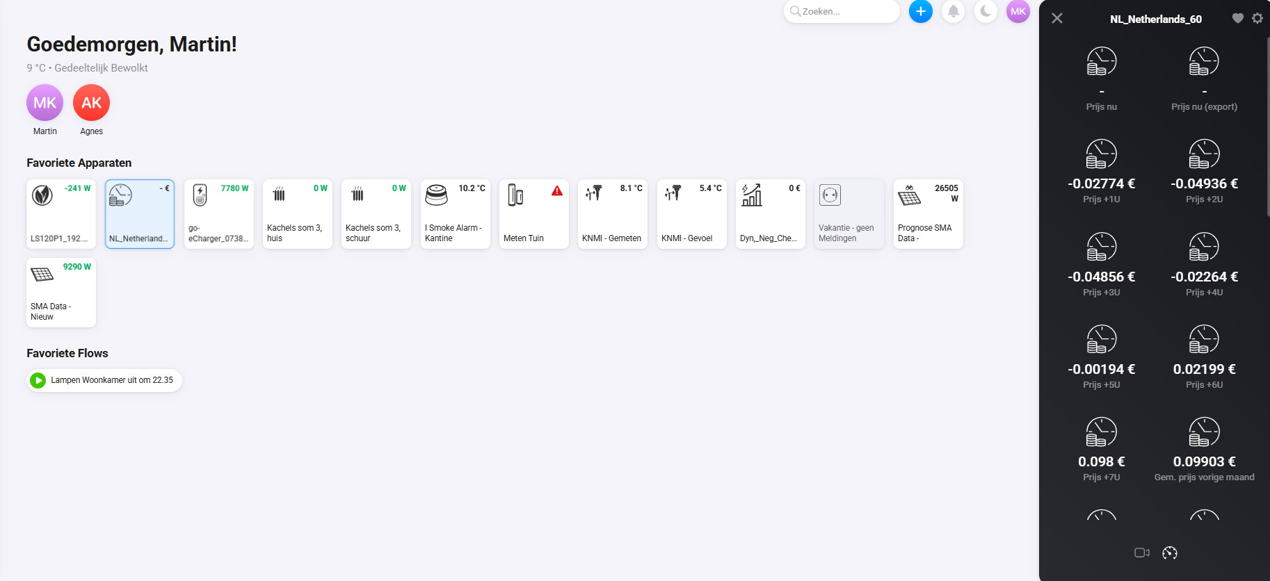

I don’t know why I checked. Everything always good. But now my flow reacted on the negative price under a certain level (-0,01849) . Now I see a disturbing hickup in the grafic. The price was indeed -0,0196 and then changed (after some seconds?) in -0,01269
@Gruijter This morning 08.05 my flow reported +2 hours price is below 0.01849: “10.00: 0.01698” instead of the correct price 0.05584. I can’t make a grafic of +2 hours price in homey so you just have to belief me on my blue eyes.
Instead I can show you a unusual price-drop from 10.00 “prijs nu”.

08.05 flow-report price 11.00 0,00009 (this is the quarter price 11.00 ipv the hours-price 11.00) (I checked, my flow uses correct NL_Netherlands_60 ipv 15 minutes device)
10.40 price 11.00 -0,00004 = correct
At one moment I see that the prices match my Zonneplan app. An hour later, nothing matches anymore. I haven’t changed anything.
@Gruijter
Sometimes the hour price from NL_Netherlands_60 is for the first minutes the price NL-Netherlands_15.
Sometimes the hour price from NL_Netherlands_60 is after some minutes the price NL-Netherlands_15.
edit 25-04: prijs aanbieder: auto
The hour price NL_Netherlands_60 is the first quarter price of NL_Netherlands_15
That screenshot shows your Homey Cloud ID in the address bar, you should remove the browser address bar from the screenshot.
