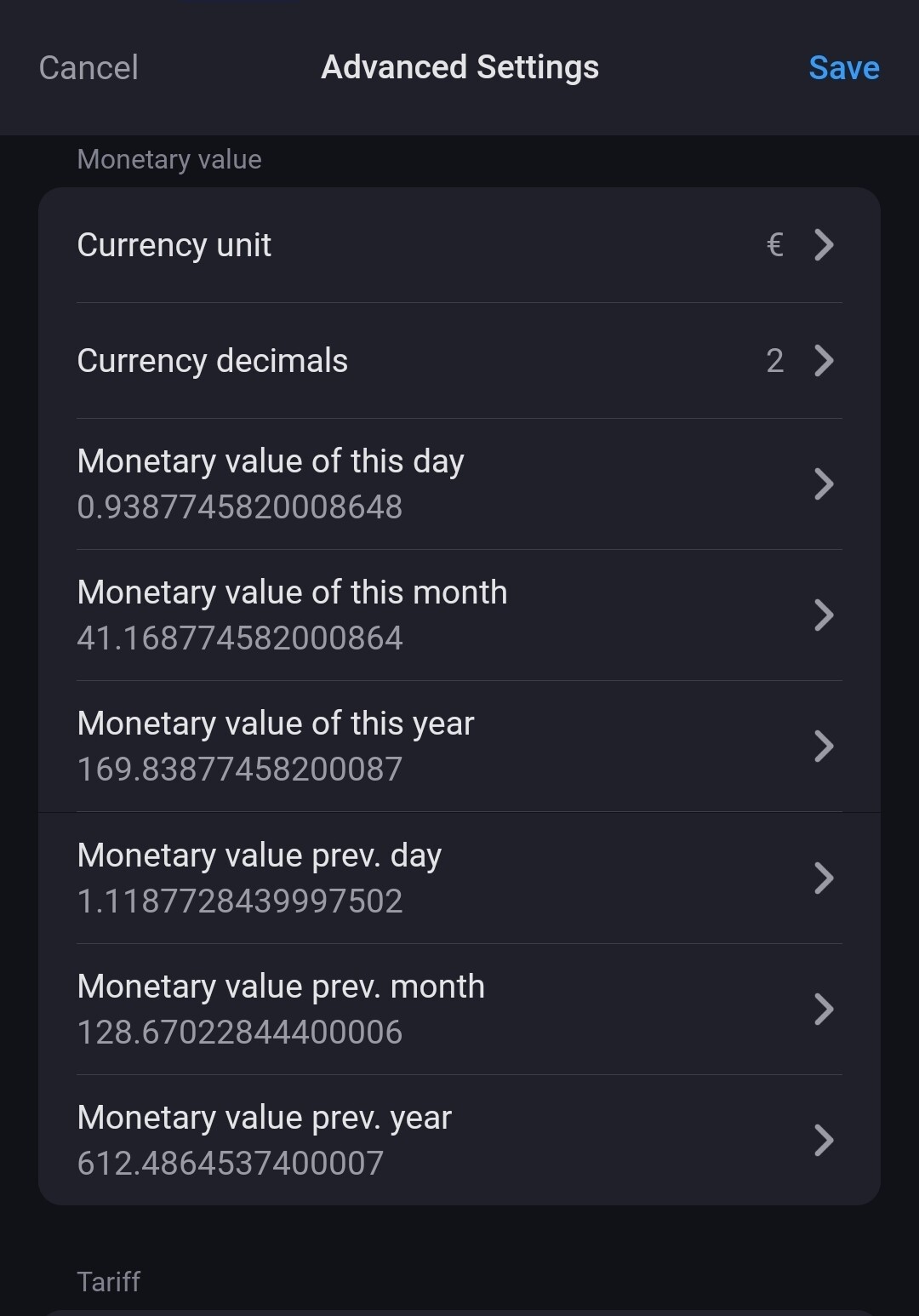

Something different. I’m under the impression I’ve seen it reported before, somewhere, but it still occurs: the non-rounding of certain values;
I think it’s an Athom firmware firmware issue, but I need your opinion if I need to report to Athom. Thanks!
PbTH sets the Homey capabilities options to use the number of decimals you enter in settings. The founding is done fully by Homey itself. I dont round the values in PBTH (well almost none). Which capability is showing faulty rounding?
