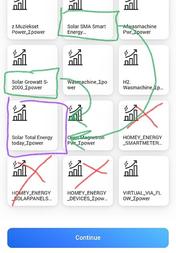

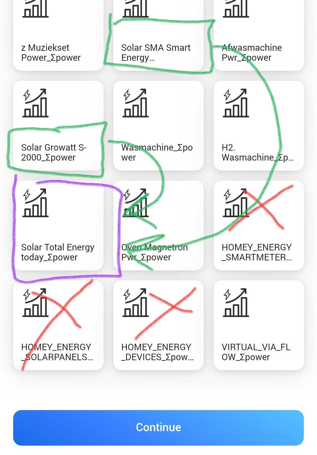

I’m using HOMEY_ENERGY_SOLARPANELS_Σpower, thinking it adds the Solax power (Solax_Σpower) and the SolarEdge power (SolarEdge_Σpower). However, there’s an inaccuracy in this, and I don’t understand why. Today, 2.04 + 1.07 gives a total of 3.87.
Any idea what’s causing this discrepancy?
I wouldn’t use Homey Energy data as input.
With a < group > app device, or an advanced virtual device (powered by the Device Capabilities app), you can create a device which continuously calculates the sum of group members
Yes I got that.
But these HOMEY_ENERGY “devices” are auto-generated by Homey Energy
The problem is, it hallucinates. I can’t find correct values, it deviates very much. I didn’t understand the “old” Energy tab, neither do I understand the new one.
Hence I recommended to use a solid way to sum the solar panels.
Here you’ll see I named it “Solar Total Energy today”, that’s my data input
(The HOMEY_ENERGY devices suddenly popped up when I moved from Pro 2019 to Pro 2026)
