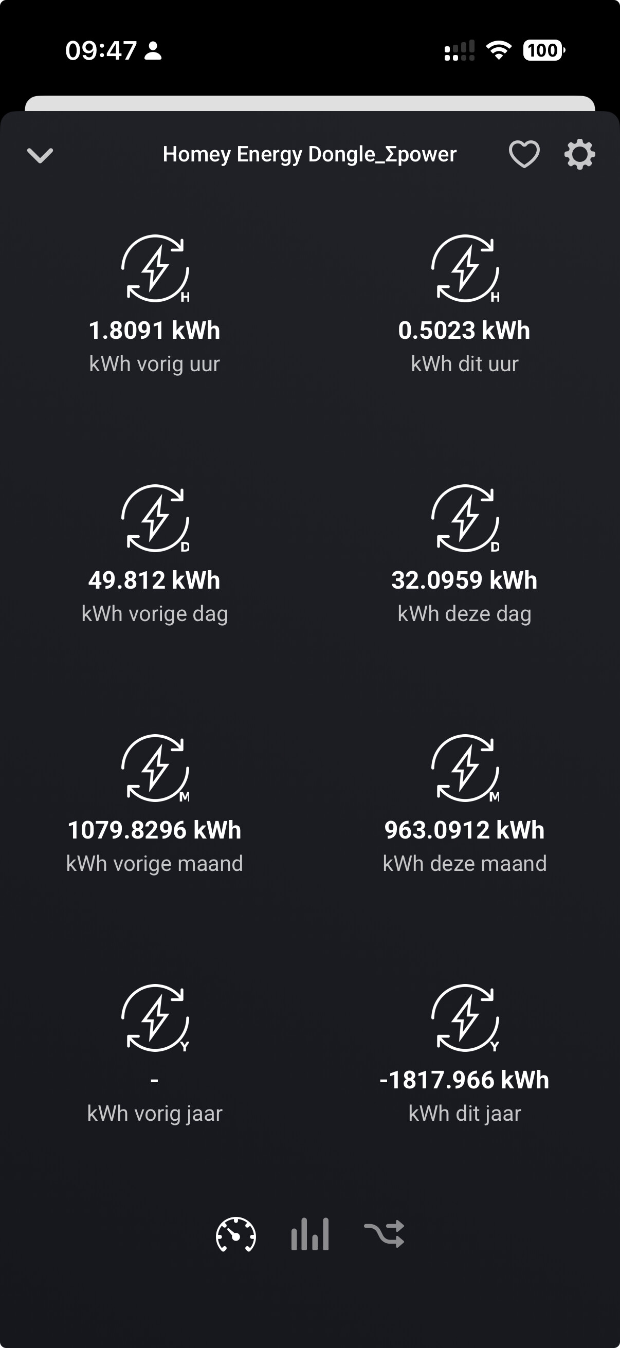

Is it possible to track kWh per fase from the homey energy dongle?
Yes that is possible, there are several measurements.
Thanks @Dennis_Fokkema what I mean is the total per Fase, so these meters split on fase 1, fase 2 and fase 3:

I have the same question. once 2026 started the counters started -2711 where it should be around 1-2 kWh. how did you solve the @rstroot:
