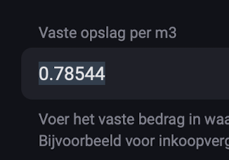

I have since found that electricity should now cost 0.14285, but to be honest, I have not yet been able to find any information about Zonneplan GAS prices. Previously, in 2024, this was 0.78544, but what is it in 2025?
Could someone help me? And apologies if I have overlooked it or could not find it on the community.

I have a problem and I hope someone can help me. My gas price from Zonneplan is not correct now, which price should I use for 2025? Does anyone have an answer to this? Thanks in advance!
This was price in 2024, but what is is now?

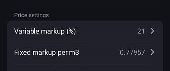

For Zonneplan on TTF_EGSI I have found 0,77954 to get the €135,22.
The flow card is also working , gives.
{“0”:1.3507,“1”:1.3507,“2”:1.3507,“3”:1.3507,“4”:1.3507,“5”:1.3507,“6”:1.3522,“7”:1.3522,“8”:1.3522,“9”:1.3522,“10”:1.3522,“11”:1.3522,“12”:1.3522,“13”:1.3522,“14”:1.3522,“15”:1.3522,“16”:1.3522,“17”:1.3522,“18”:1.3522,“19”:1.3522,“20”:1.3522,“21”:1.3522,“22”:1.3522,“23”:1.3522}`

I used the wrong day ahead market, I adjusted my previous post accordingly.
The €1.3692 from PbtH became €1.3693 in the Zonneplan app.
The change on TTF_EGSI for ZP make the Fixed markup there 0,77956.
Still is changing that value very difficult.
It takes hours to see it back in the file and in the virtual device ZP G.
The gas price for tomorrow by PbtH is €1,3677.
We shall see it in the app.
You can use a flow(card) “Set fixed markup to …” to changes the markup.
