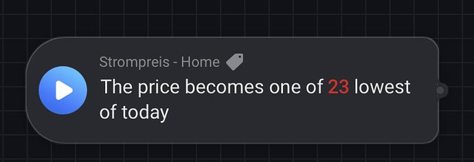

@Gruijter is there any reason why some flow cards only allow 1-16 as value? For example “Price becomes one of [1-16] lowest of today”. I basically want to do a flow which will set the heating temperature to 18°C if it’s one of the 3 highest, but to 22°C if it’s one 21 lowest prices today, which is not possible currently. And I get that I can use price ranks etc, but why not also just allow values from 1-23 for those other cards?
You can just put any value till 23 in. The showed values are not the fixed range, but an example. Try it out

Tried that but it gives me an “Invalid arguments.” error when saving
Just use the AND card version, and use the price hour changed as trigger.

I can also use the rank card, but is there any reason to not allow a larger range for this card?
Its mostly to manage expectations. Only about 8 hours of future prices can be guaranteed. 24 hours of known future prices is only available between 14 and 23 o’clock.
But if you insist of using a higher number; there is a workaround. Use a tag with the number you want in stead of directly typing in the number in the flowcard.
But this (and the reverse card) are only about prices for the current day, for which the full 24h range should be known
