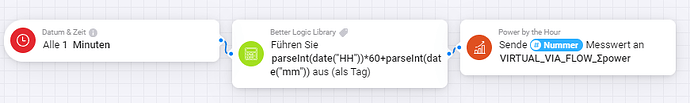

Not sure if you’re still interested in identifying bugs with respect to summarizers with daily reset, but the following might help a bit:
I created a virtual summarizer and activated the daily reset:
Then I created a simple flow that just sends the daily minutes (0-1439) as energy to that device:
This will result in the following data from the virtual summarizer:
Energy looks fine, power has that short negative spike at midnight and “kWh previous hour” is zero from 00:00 to 00:59.
Thx for the extensive insights! It certainly does narrow down where to search. But havent found the cause.
Honestly speaking, I think that this bug with the test flow is independent from the one I experience with my heat pump energy. With my heat pump summarizer I see small positive spikes every hour, while with this test summarizer I see a big negative spike at midnight. The energy fed to the summarizer in both cases has no spikes at all.
My best guess would be that something is fishy with the handling of the daily reset. I was under the impression that the small spikes I see with my heat pump summarizer have about the size of the total energy by last midnight. So maybe somewhere the app handles the daily reset flag incorrectly and refers to the total energy when it should refer to zero (or vice versa).
Let me know if I can be of any help.

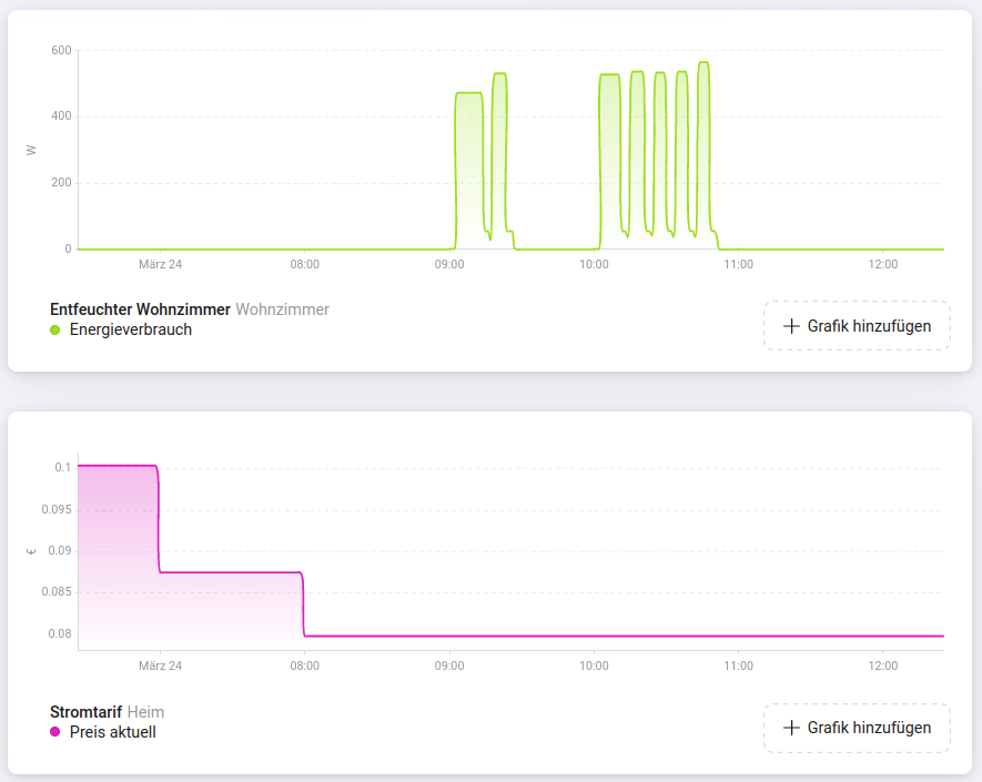

Hi, it’s me again (I’m sorry). I’m using the flow card “Price is the 1 lowest in the 3 hours before 12” to start a device in the cheapest hour between 9:00 and 12:00:
Today prices are absolutely identical between 8:00 and 16:00 and PbtH triggers that flow in every of the three hours between 9:00 and 12:00 instead of just one (I manually turned the device off at 11:00):
I don’t think that the flow card “Price is the x lowest in the y hours before z” should behave that way. It should only trigger for x hours, no matter how many hours in the relevant period have an identical cheapest price.
Present behavior is known and intended. You can use advanced flows to limit the total number of hours in a day.
