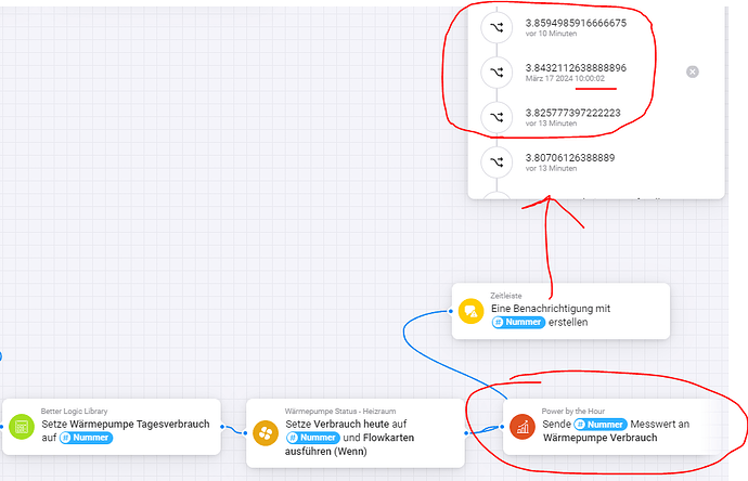

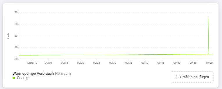

Any idea what’s going on here? :point_down: I have a PbtH summariser that is fed by a flow with the energy from my heat pump. Sometimes, exactly on the hour, the energy jumps:
The energy is fed by one flow (and one flow only), and I have checked that only one value is sent on the hour.
The jump seen in the insights lead to incorrect energy for the current hour. Other values, e.g. the energy for the current day, are fine.
The jump is only visible in the PbtH summariser, but nowhere - neither earlier nor later - in the actual value fed in.
Anything I can do?
Try sending it a minute before the hour, or better yet: send it much more often (e.g. every minute)
I already send it exactly once a minute; take a look at the timeline in the screenshot.
It might be important that I have daily reset activated for that summariser:
