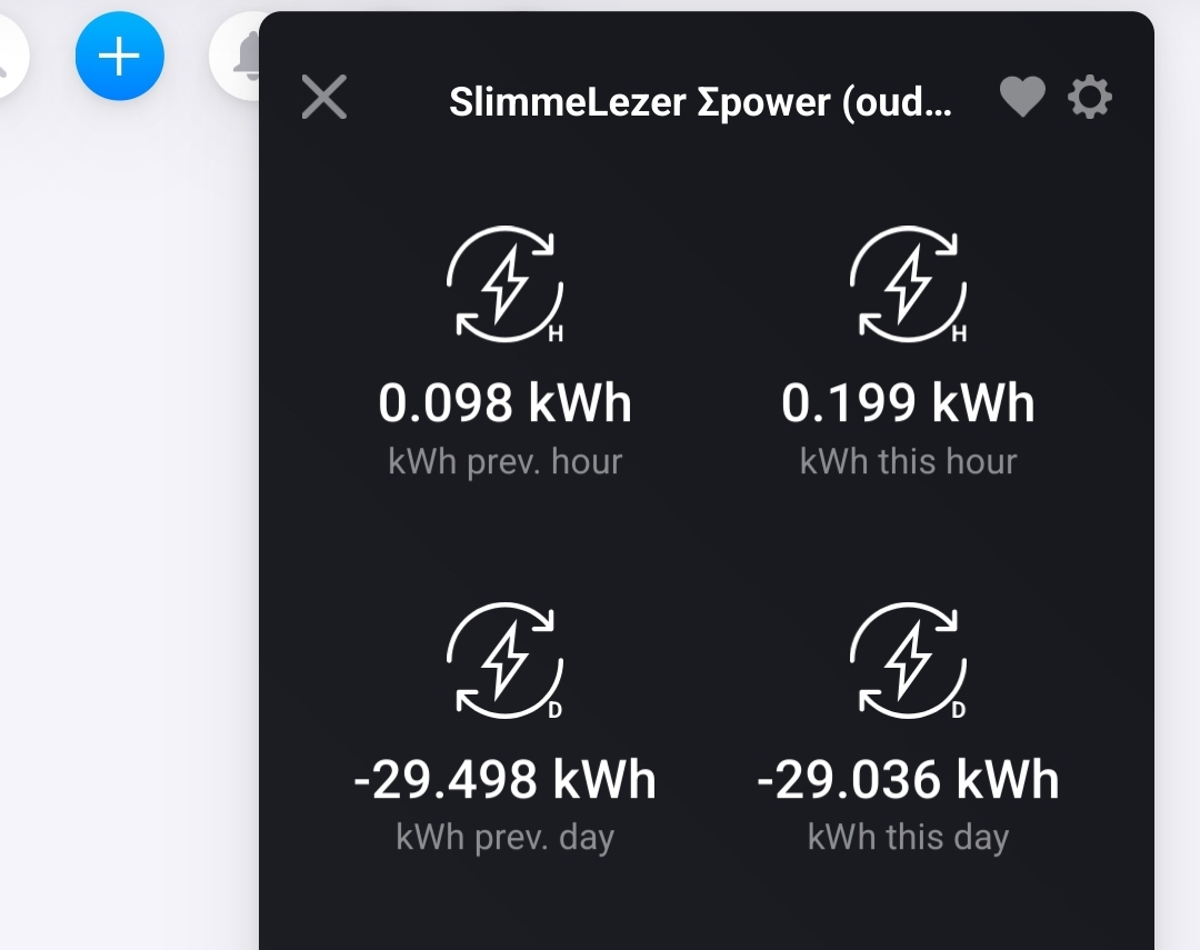

Solar power makes the counters go backwards.
When the Energy production is higher than the consumption, the kWh counter counts back, and becomes negative:
As you can see at [kWh prev. hour] and [kWh this hour], they’re now counting up, because the solar production is less than my power consumption.
