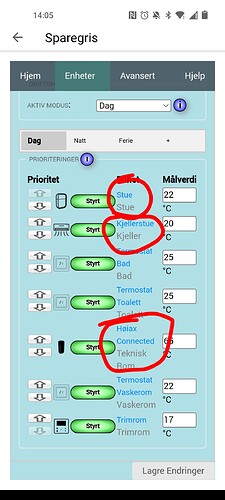

Not sure if it’s a bug or not, but I noticed some weird behavior today.
At 2pm today, a few devices was turned off. Nothing unusual in itself, but the devices that were turned off did not reflect the priority I have set up in the app.
The marked devices did turn off, while the rest remained on. So my top priority devices were turned off, while my lowest priority devices remained on. One of the lowest priority devices was drawing power at the time. So did my top two.
Are there other factors taken into consideration other then priority order, when the app decides to turn a device off, or is this a bug?

Just to check, The priorities you observed, did they by any chance fit with the priorities for another mode?
No, same priority for all modes. Don’t use the mode function at all actually, but checked the settings for them anyway, and they are in the same order.
Ok. If it was related to lost signals then it could be a one time incident. If it doesn’t resolve then we probably should make a bug report at it here: Issues · frodeheg/no.sparegris · GitHub
