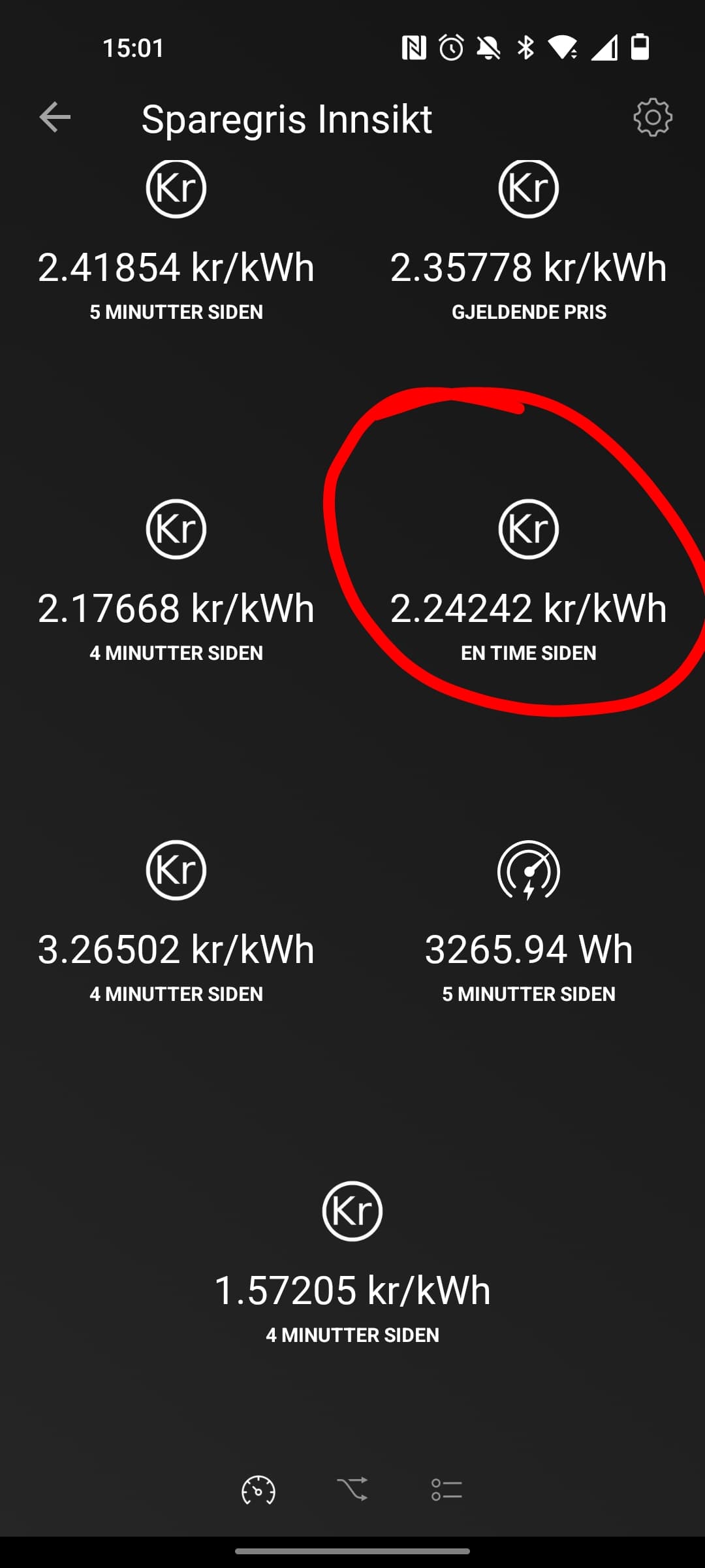

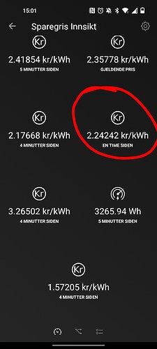

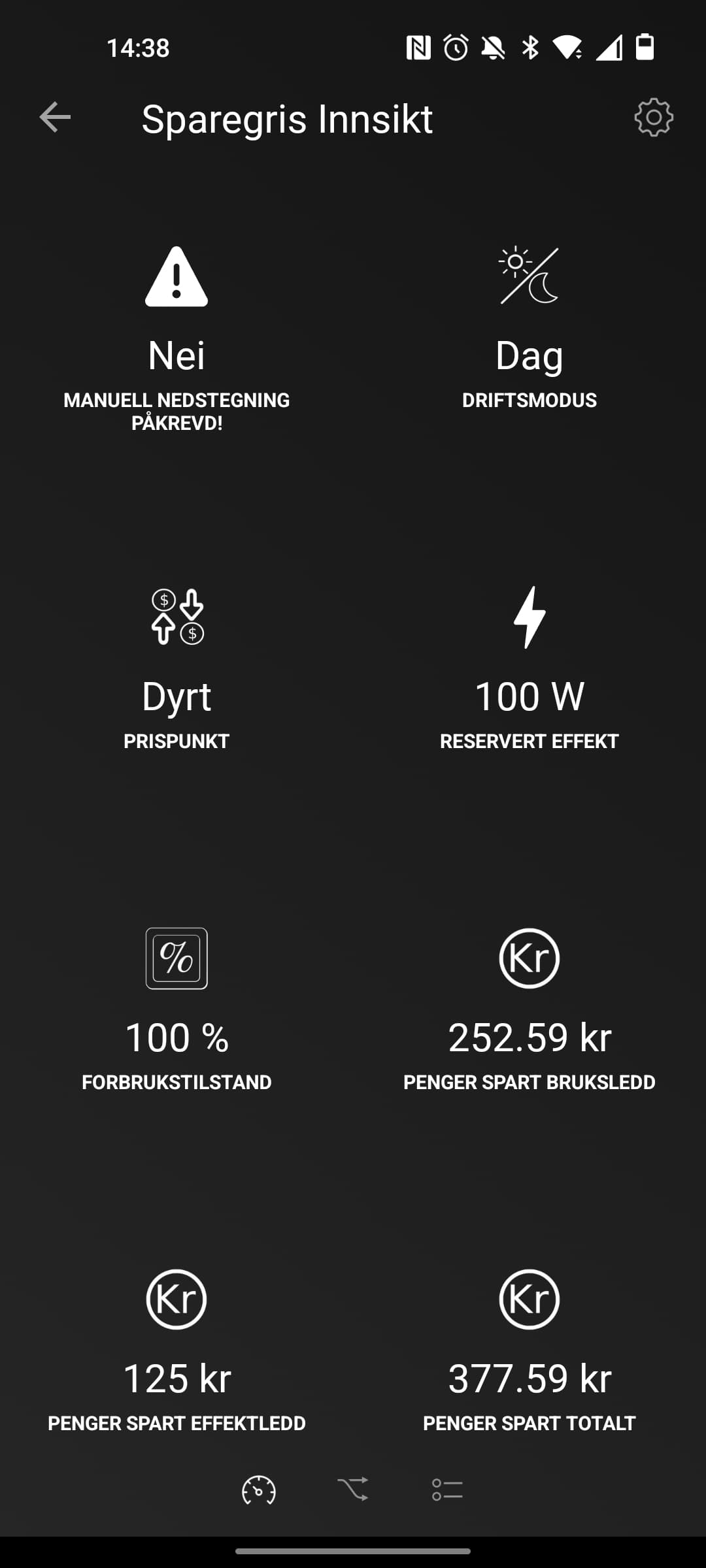

Having some more issues today.
Price point is off.
This hour is 19 øre below today’s average price. Just under 10%, so my price point should be normal.
However, limit for high price is for some reason set lower than the average price.
And price point is set to expensive.
Bug in the price fetching, or the calculation?
Edit:
Rebooted Homey. All other price limits was refetched, but the limit for high prices seems stuck.
You are being hit by the case “minimum number of expensive hours per day”
You can adjust this limit in the settings if you’re not happy with it ![]()
Intended behaviour.
But how is that possible? I have set a minimum of 4 expensive hours. The hour between 2 and 3 pm today was the 7th cheapest hour of the day. There are 17 hours more expensive then that one.

I have no idea, this need to be investigated future. You can track this issue here: High prices are reported not to work properly · Issue #29 · frodeheg/no.sparegris · GitHub any further info you might have or statistics / logs / graph would be greatly appreciated if you put it into that issue.
Haven’t seen it happen again though. To me it seems like the high price limit was calculated wrong for that day.

I have now high price and low price equal. So seems to be something wrong with high price. The price is cheap now, but since high has same value as cheap it is set to expensive.

So, I can confirm something was wrong, and it has been fixed here: High prices are reported not to work properly · Issue #29 · frodeheg/no.sparegris · GitHub
Apart from that having a high and low price limits equal is not strange in itself as it would happen when you have to clamp the price limits to observe a minimum number of cheap/expensive hours for a day.
However, as many people get confused by this I wonder if I should add a minimum amount of normal price hours to set them apart. Should I do this to ease any confusion?
