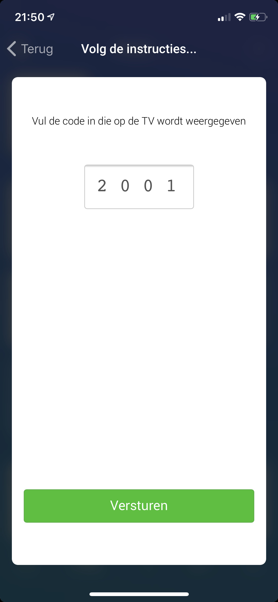

Hi @lucasvdh I need your help, when I tried to add my TV, I also get an “De pincode is incorrect” error.
My TV is from 2016 and model is: 43PUS6501/12 Software version is QM163E.0.26.68.0 (7 nov 2019)
Response on: http://“TvIPnumber”:1925/6/system
{“notifyChange”:“http”,“menulanguage”:“Dutch”,“name”:“43PUS6501/12”,“country”:“Netherlands”,“serialnumber_encrypted”:“Wpi8wVsczHduwjkI+PEYsZzZkYd9og+GCCOghXx7aWE=\n”,“softwareversion_encrypted”:“PNkjv0hA3fiQ1VogQz76br2sVOc6FJHcD4IaXSDjVMc=\n”,“model_encrypted”:“r3qmEuCseAotZzf3O3/tJzcYCl/2bTky2udkU4i7jnk=\n”,“deviceid_encrypted”:“RBrZquIXITiXQxr2qbQv1zPtXM9CSwrC9CzzLuZE2vE=\n”,“nettvversion”:“8.1.3”,“epgsource”:“one”,“api_version”:{“Major”:6,“Minor”:2,“Patch”:0},“featuring”:{“jsonfeatures”:{“editfavorites”:[“TVChannels”,“SatChannels”],“recordings”:[“List”,“Schedule”,“Manage”],“ambilight”:[“LoungeLight”,“Hue”,“Ambilight”],“menuitems”:[“Setup_Menu”],“textentry”:[“context_based”,“initial_string_available”,“editor_info_available”],“applications”:[“TV_Apps”,“TV_Games”,“TV_Settings”],“pointer”:[“not_available”],“inputkey”:[“key”],“activities”:[“intent”],“channels”:[“preset_string”],“mappings”:[“server_mapping”]},“systemfeatures”:{“tvtype”:“consumer”,“content”:[“dmr”,“dms_tad”],“tvsearch”:“intent”,“pairing_type”:“digest_auth_pairing”,“secured_transport”:“true”}}}
I also have problems with pairing my tv. I can’t confirm the code i get on my tv. Is there a solution for this?
