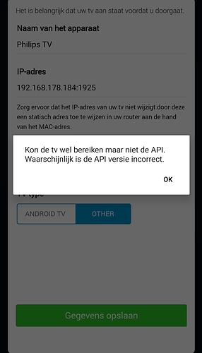

Still can’t add the tv unfortunately. When I put the port behind I get at api 1 a different message. Maybe someone has an idea. I tried Al the API versions
