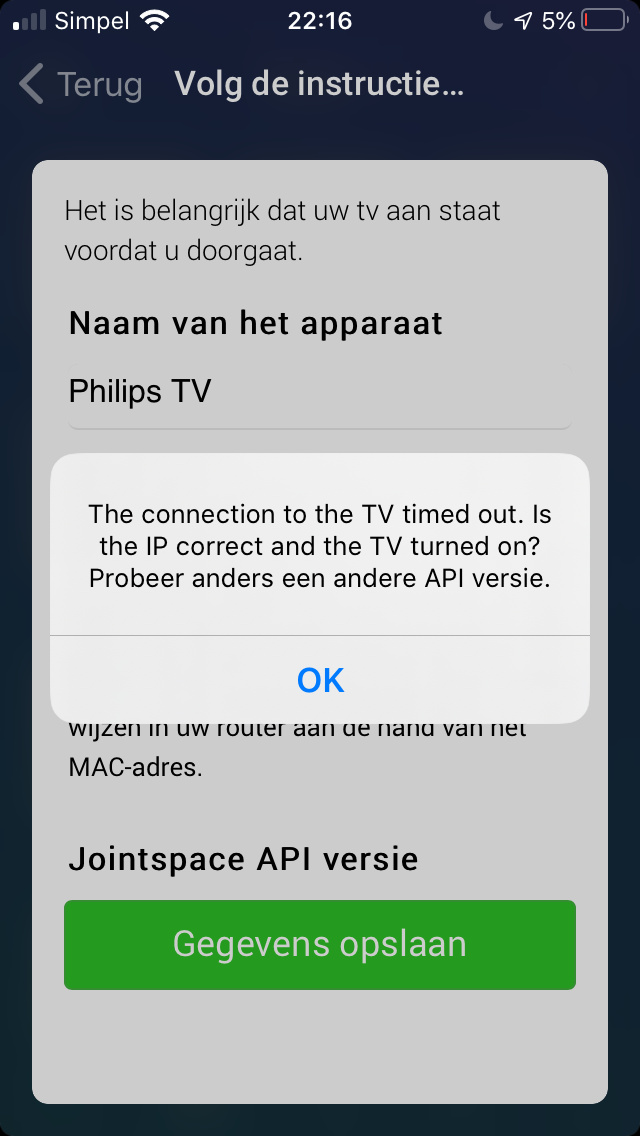

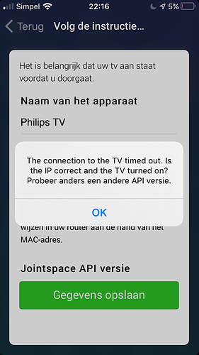

I am trying to connect our Philips TV (48PUS7600/12) to our Homey but was not yet successful.
I found out our IPadress and the API setting:
https://192.168.178.248:1926/5/system
{“menulanguage”:“English”,“name”:“PhilipsTv”,“country”:“Germany”,“serialnumber_encrypted”:“z1y6VLZcqWxWZU2Xh97oW8zBLm44WydJuF0V803ZQJk=\n”,“softwareversion_encrypted”:“HxsNn5wTTwWIoRDMITeOPo2pG/LnsPX1u7pak+rxKpc=\n”,“model_encrypted”:“Vhx2MuMiW7wzO613M0GC3YdXE/bodTfhJHqCpHPFSvs=\n”,“deviceid_encrypted”:“RJDwmsPUgGODrPoC4jBSJC4KdSyskIwORqorZkW8pWY=\n”,“nettvversion”:“5.2.0”,“epgsource”:“ip”,“api_version”:{“Major”:5,“Minor”:2,“Patch”:0},“featuring”:{“jsonfeatures”:{“ambilight”:[“LoungeLight”,“Ambilight”],“textentry”:[“context_based”,“initial_string_available”],“inputkey”:[“key”],“applications”:[“TV_Apps”,“TV_Games”,“TV_Settings”],“pointer”:[“not_available”],“activities”:[“intent”]},“systemfeatures”:{“tvtype”:“consumer”,“content”:[“dmr”,“dms_tad”],“tvsearch”:“intent”,“pairing_type”:“digest_auth_pairing”,“secured_transport”:“true”}}}
So I tried connecting with:
IPadress: 192.168.178.248
API: 5 (Tried all the options)
TVtype: Android
I made sure I have a static IP, WoWLAN is enabled and the TV is turned on.
The app is loading for a while and than returns:
Anyone familiar with this problem?
