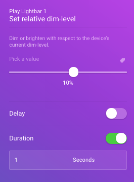

I use these flows:
This is the setting on the action cards (and -10% for dimming down)
Dimming up or down works flawless by holding the dim buttons, the slight duration makes it all smooth.

Haha… you are correct… I overdid it by using the variable… works just fine without it :smiley:
Yes, I can confirm this. It works flawless, thank you @DaneedeKruyff! :+1:t4:
