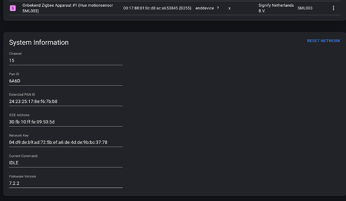

Hi Johan, Mike,
Same here with two units, also SML003 model. interview shows info below:

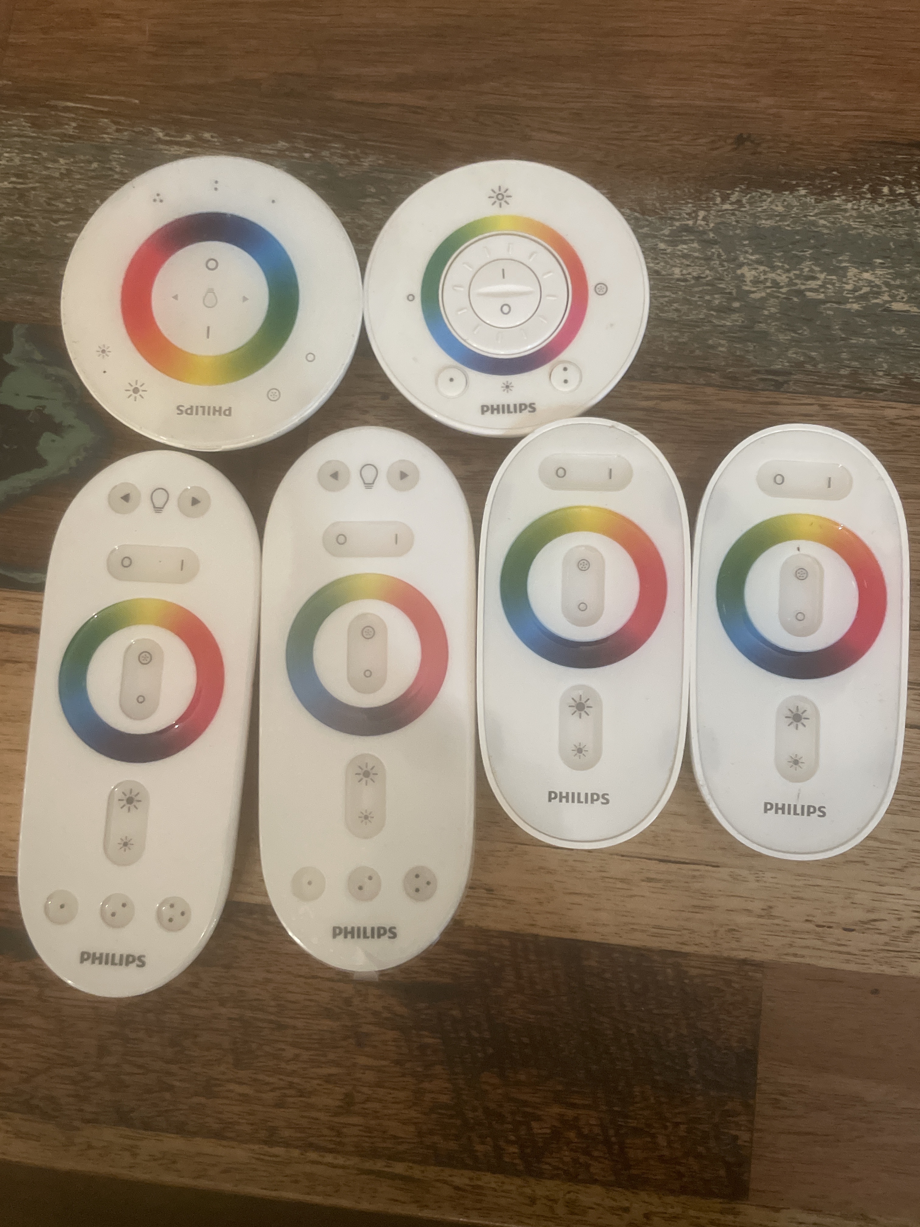

Hey Johan,
So I have some Philips hue remotes, the are unfortunately no longer available, but you can still get the bridge to add them. They are using zigbee much like the original living colours lamps.
I was wondering what your thoughts are on adding these older remotes to the app? Happy to send(buy) you one to test with

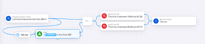

hello, I can’t create a flow that allows me to turn on a lamp with the outdoor detector only when it’s dark, can you help me Please

A bit out off topic for the thread, but since it’s the Hue sensor… :slight_smile: Something like this?
I added a check to make sure the lux value is still lower than a set value, else the flow might trigger several times.
I need some Zigbee info to tell… but unless you have not yet, please try the test version of the app first.
If I remember correctly those will not pair with Homey, if you are able to pair them as generic Zigbee units please let me know. As FKey says there is an alternative way to use those.
Thanks I’ll check it out today, it is possible to use them to control hue lights, I just thought it would be great if I could use them to control other devices in the house. They are really good remotes, far better then the newer hue remotes.
