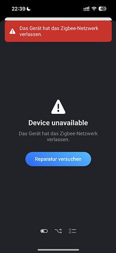

Migrated yesterday to the new Homey Pro 2023, almost everything from philips hue works fine. But 1 thing isn’t working, the temperature and lux values from the motion sensors aren’t updating. Only after removing and adding it works again :frowning:
Has anyone else notice this?
