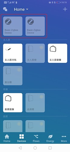

Hi @abchung726, what kind of Cher light is it? Ceiling or Pendant? I will have to add your Product Id to the app. (different colors can have different product Id’s)
