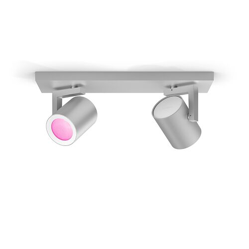

Hi Johan,
As we talked earlier about, here by some info for the: Argenta 2-lichts
2-spot:
light one:
  "ids": {
    "modelId": "5062248P7",

Hi Johan,
As we talked earlier about, here by some info for the: Argenta 3-lichts
3-spot:
Center light
