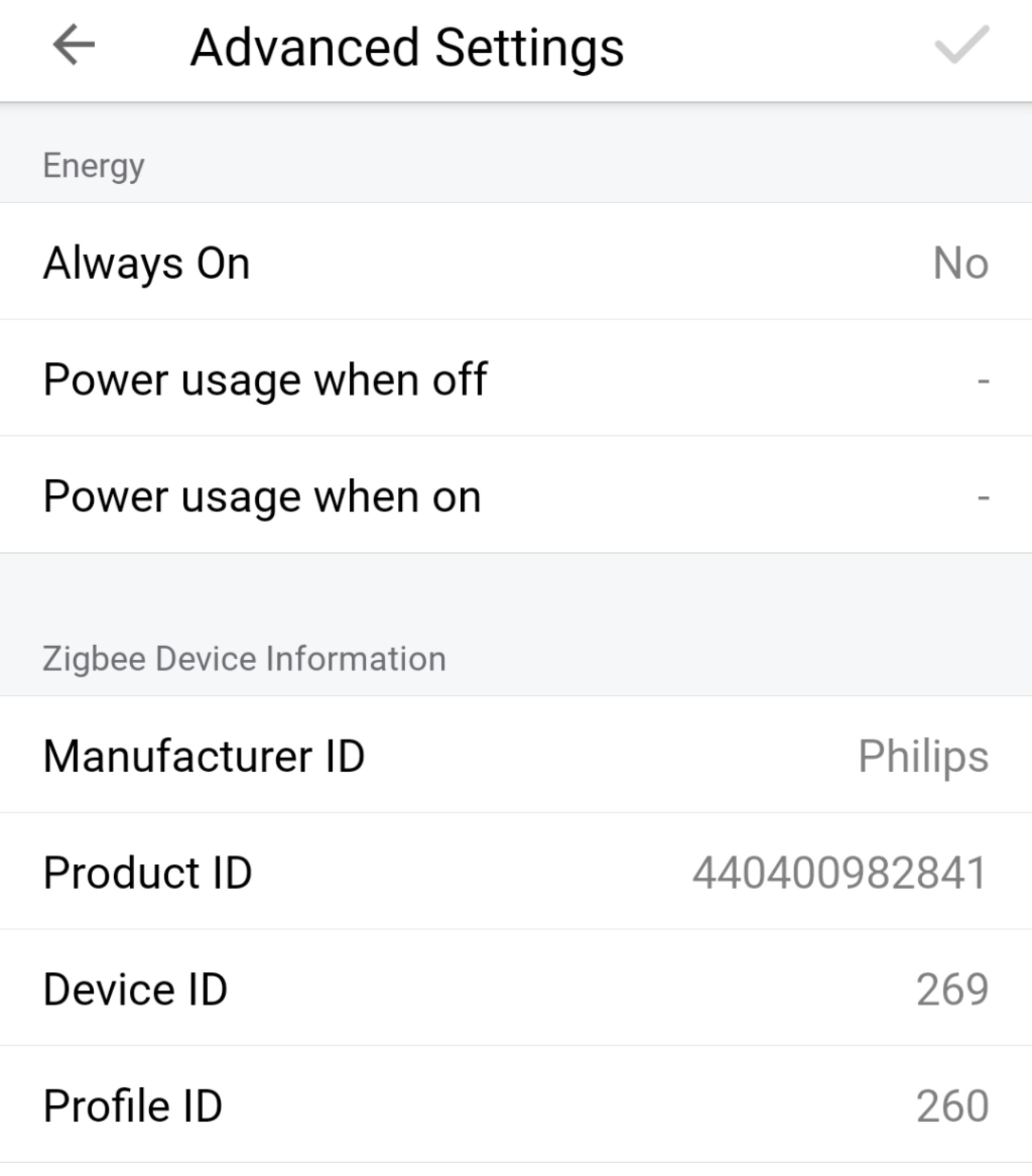

@Vicky Have you provided the right ID’s, then it can be used in v4 after the update, concerning:

Hi, so my Play lightbar should already work in 4.2?
It is recognized as generic device with those values
Cheers
I think they work in V5, not in v4.2 yet:
Added to the firmware 5 version of the app. I’ll look inte adding it to the firmware 4.2 version soon.

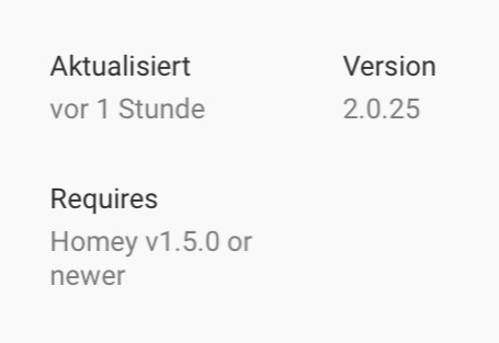

Hi @johan_bendz,
I guess there went something wrong with the latest update version 2.0.25 (Experimentell).
I hope not, it’s for firmware 4.2
And what is the actual version for v5.x?
image image
Version 2.0.24 is the latest version for firmware 5. Once I have version 2.0.25 as stable for firmware 4.2 I will release a new 2.0.26 version for firmware 5. Anything special you wait for? :slight_smile:
Maybe I’m a little bit stupid, but there is no v2.0.24 available in the App Store. That’s the only thing what I want to say.
@johan_bendz Indeed normal store is right now on 2.0.18 and test store is on 2.0.25. And it seems 2.0.25 (test) can be installed on Homey 4.2, so I think there is no V5 version anymore.
Thank you, @rvdeijk! I’m not stupid! :pray:t3::wink:
Ah, yes… that’s correct. The only way to update 4.2 is to remove 5. Once Athom has accepted the new 4.2 version I can upload a new 5 version. Confusing… I know :joy:
