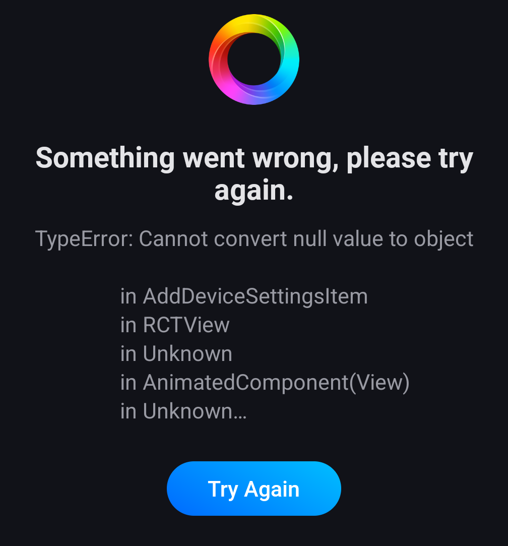

Hello @Edwin_Biemond ,
I’m just starting out with Homey (Pro) and tried to connect my AMF870/15. It does connect but after that in the rest of the setup I get an error as attached image
I have seen a few topics where the AMF870/15 was mentioned, but nothing like this. Shpuld I just stick withe the native Philips app or is there something I can do?
can you send me a report, will check
Hello Edwin,
I made this report after another try. The code is:
d0d80a9a-aae4-4955-9d5b-07c26d4d0900
Thanks for reacting so quickly and I hope this is what you needed.
Ted
I see timeouts, is ip correct, wifi on 2.4 ghz only. any firewall rule which blocks the way back to homey?
