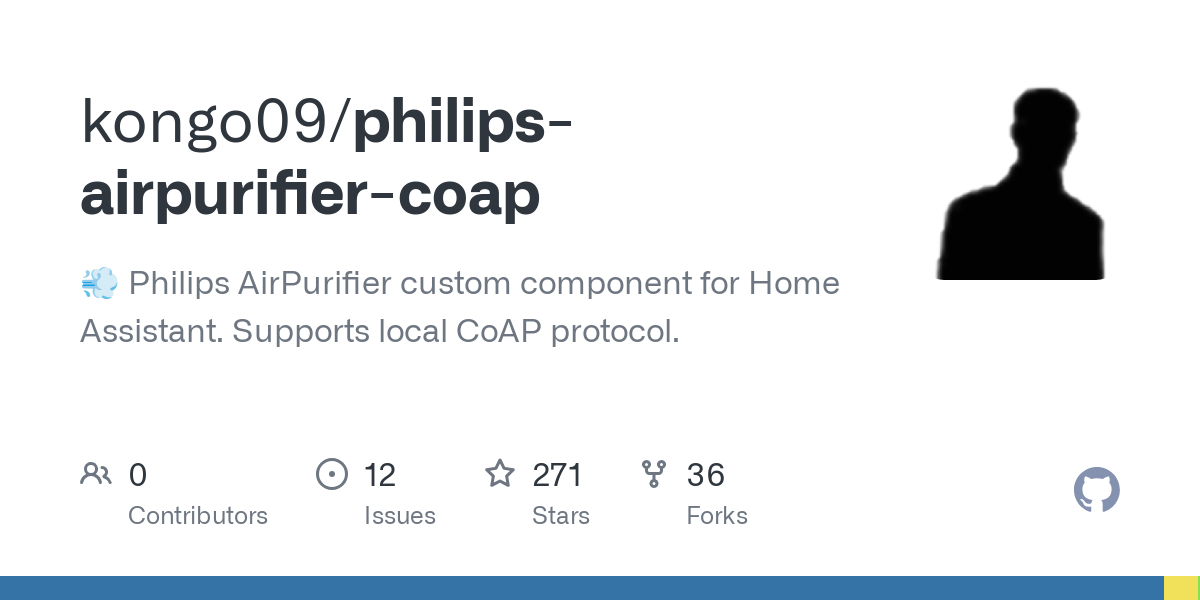

There is an extensive app for the home assistant and I am curious if you might be able to use that code to add multiple models. I have no knowledge of this myself, so if it isn’t possible, that’s a shame but understandable.
