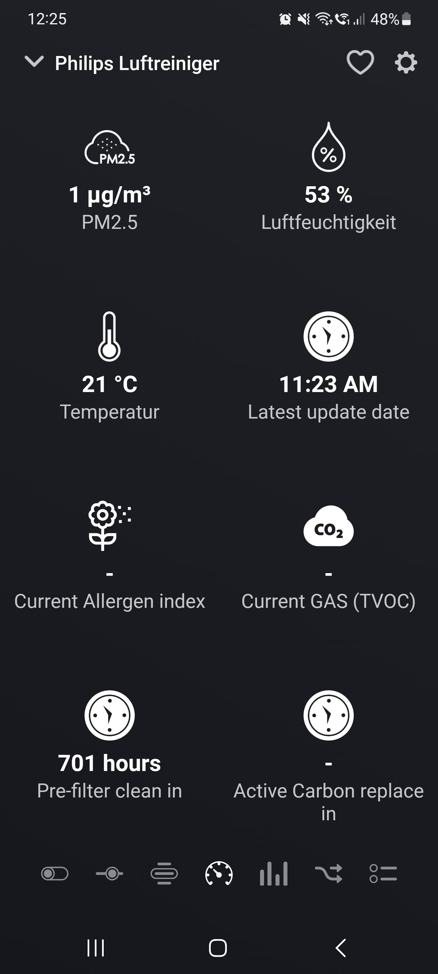

Yes, I see some values

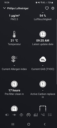

let me check, I see pre-filter is probably not correct and see some issue on child lock.
new version to test , where I fix child lock and the filter replacement Philips Air | Homey
Report. 3da929b1-e3af-4a24-b401-f42ffc5088ec
Now I see this.
I think the Filter replacement is correct.

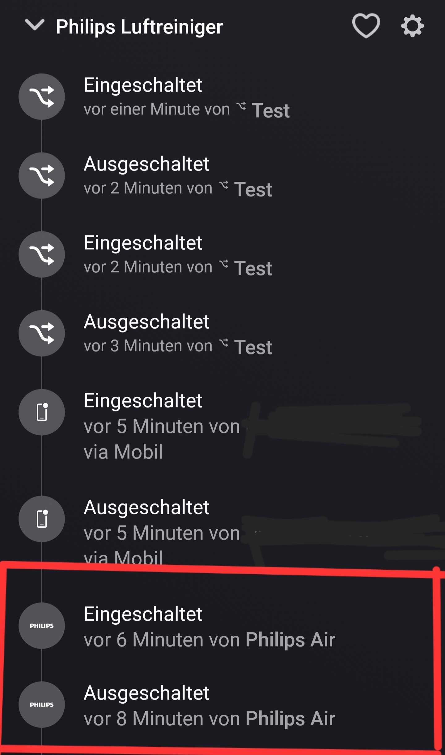

In the screenshot below, What happens in the area marked in red?
Report: 8e62c5c5-74c1-4574-8893-0367922944a3

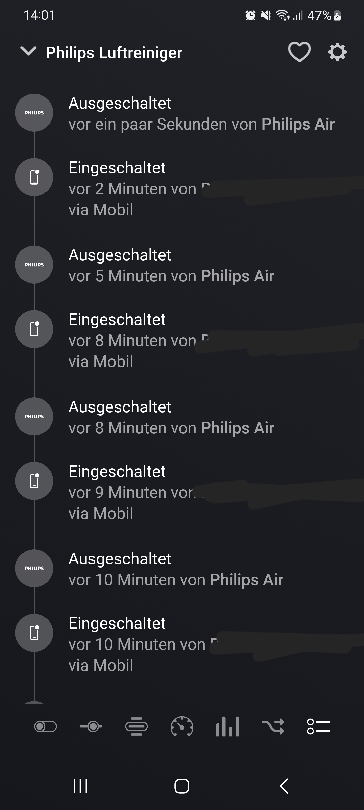

I don’t understand why does this happen? The device is allways off!
When I turn on the button in app, after a few seconds or minutes, the device is turned off by Philips air. But only the button is turned off.
I understand better now.
When I turn on the device with the Philips air app, then the device turns on. In Homey app, the button is also set to On.
