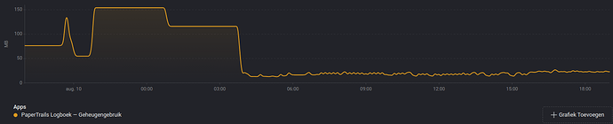

Everything is OK again since 3AM.
Homey was yesterday evening at 7PM soft rebooted by my.

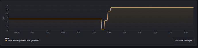

Papertrails suddenly gets paused every time the last (half) hour, I can’t find or think of what I’ve changed.
The memory useage of PT goes up to 130MB’s.
I took the liberty of sending a crash report (although it did not “crash”).
