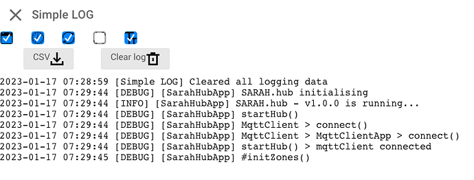

Do you mean something like this ?:grin:?
Advanced Flow Logger:
App Logger:
When proceeding as described above, athom was not so enthusiastic. But in the meantime I have rewritten (my) whole logging system so that everyone is hopefully happy.
The Advanced Flow Logger is ready and I’m using it on my end.
At the moment I’m implementing the App-Logger, via the new SimpleLogApp interface, but it’s not running smoothly yet because of TimeOut problems on the App side.
