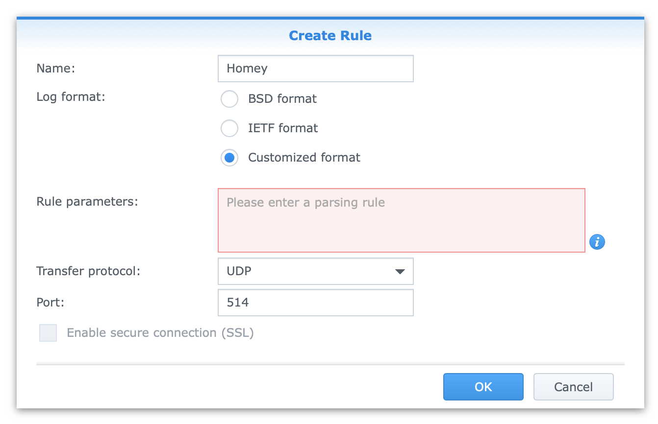

I would like to config syslog, but I am not sure how to create a rule for this? What is the log-format?

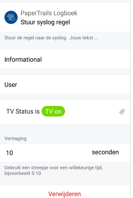

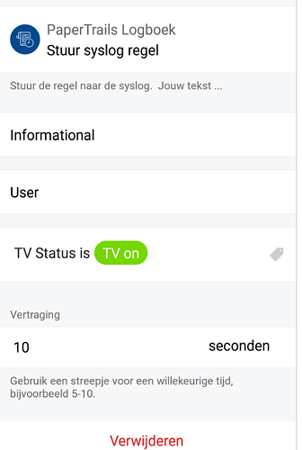

I configured the Papertrails app to forward to logs3.papertrailapp.com:21074 and configured https://my.papertrailapp.com with the ipaddress of my router.
But the PaperTrails Logboek “Stuur syslog regel” is not showing up.
Any ideas?
Mine works with writing a normal log line “voeg toe aan de log”.
That part is working okay.
The problem that I have is sending/writing a syslog event to SolarWinds Cloud
With the card I indicated it writes already to papertrails webapp. Have not yet used the “write to syslog” card.
