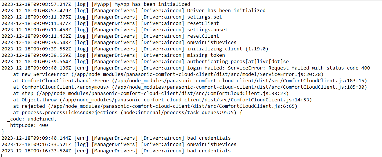

This looks similar to other reports. I hope to get some time this week to investigate. Could you send me (PM) the log contents from the app settings page? This might help pinpoint where to apply a fix.
I fixed a rather embarrassing typo, pushed to version 1.1.2. Let me know if it helps!

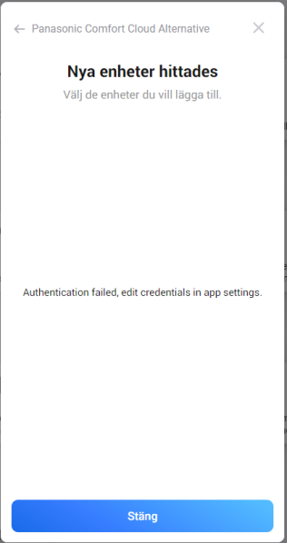

I get error when trying to connect with to my Panasonic acocunt.I have added the Homey Community space app to my Homey Pro 2023.
I have added the credentials for a new user in âHomey Community space /Configureâ (the admin account didnât work so I added a new Panasonic user with full permission in the PCC app).
When I create a new device, I get error according to attached image.
Translated, the first lines are: âNew device found, choose which devices you want to addâ
What am I missing?
Have you tested the new credentials using the phone app? Sometimes an account has to approve terms and conditions before it is allowed to authenticate.
Make sure the password is entered correctly, of course. When copying and pasting, itâs easy to mistakenly include a trailing space, for example.
I donât have any other suggestions, Iâm afraid.
By the way, I think the version available in HCS is out of date. HCS itself is pretty much defunct and under new development.
For the time being PCC-alt must be installed manually using the Homey SDK CLI.
