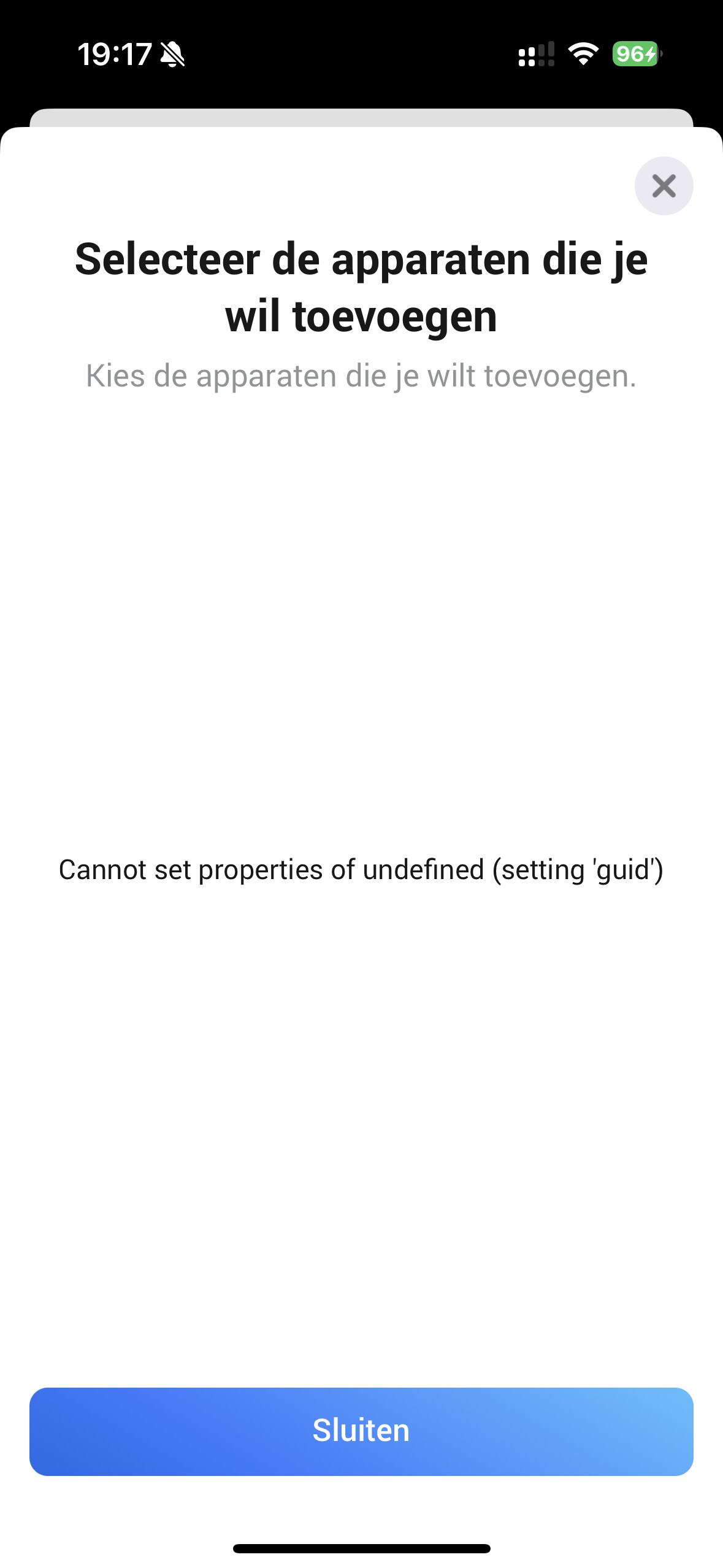

Hi!
I’m trying to add the airco’s, but I got this message
Any ideas?
Thanks!
