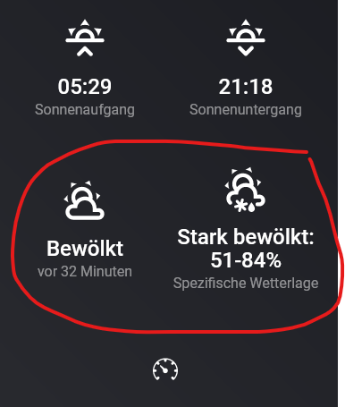

I don’t have those percentages in cloud cover.
Is this only for a few weather types? I’ve tried adding device again, same result.

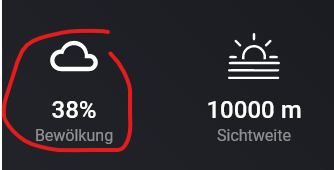

cloud coverage (or cloudiness) is available in all devices, current weather, hourly and daily forecast:
grafik
yes I have and then only one value. What you have circled in red there are two values. at that strak bewölkt 51-84% i don’t have that.
Ah, that are weather conditions. First the main condition like clouds, rain, clear and the second one is the specific (detail) condition.
That are enum values defined by the OWM API.
https://openweathermap.org/weather-conditions
In the device view, the description is displayed. The capability has the technical ID.
You can use these values as flow condition. For use as text (timeline or push), the description capability is better.

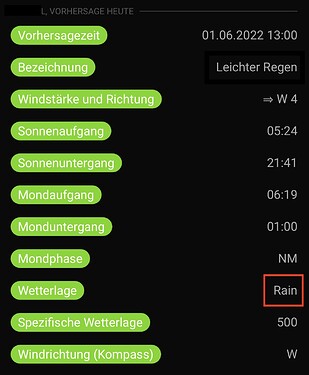

When I look at the weather data e.g. in the smartphone app, all the texts are in German language:
But if I want to use global tags in flows to get today’s weather forecast via TTS, then the same global tag is in English language:
Why?
Is it possible to translate the global tags also?
Hi Dirk,
that are the weather condition IDs from OWM:
The capabilities are defined as enum type (fixed list with ID and description). So you see the description on the screen but inside, the ID is used. That way only valid values can be used.
The same IDs are used in the conditions to select a value in a dropdown field.
But I’ll check if I can add a text capability for you :wink:
