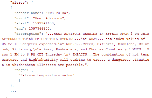

In case you get bored some day :grimacing::wink:, how about adding ‘National weather alerts’?

Yes, I know that. But it’s only text and only english. That can’t be easily shown in capabilities. It doen’t really fit into the app. But I can search for a good usage.
If you lived in Germany, you could use that :shushing_face:
Hehe, that’s a pity.
There’s (Dutch) apps like f.i. Buienradar/ Weeronline/KNMI. But I don’t really want (and there’s no RAM left) another weather app.
I understand, I was thinking of a flow triggercard, like ‘Weather warning’ or something like that. The rest is up to the users’ creativity :grimacing:
It looks like that:

So perhaps start/end time and the first tag?
But there could be more than one alert…every solution will only be a partial one.
Oww that’s the complete 8 o’clock news! Hehe…
Yeah I think the first tag will do, with the start time. And eventually the end time as well.
