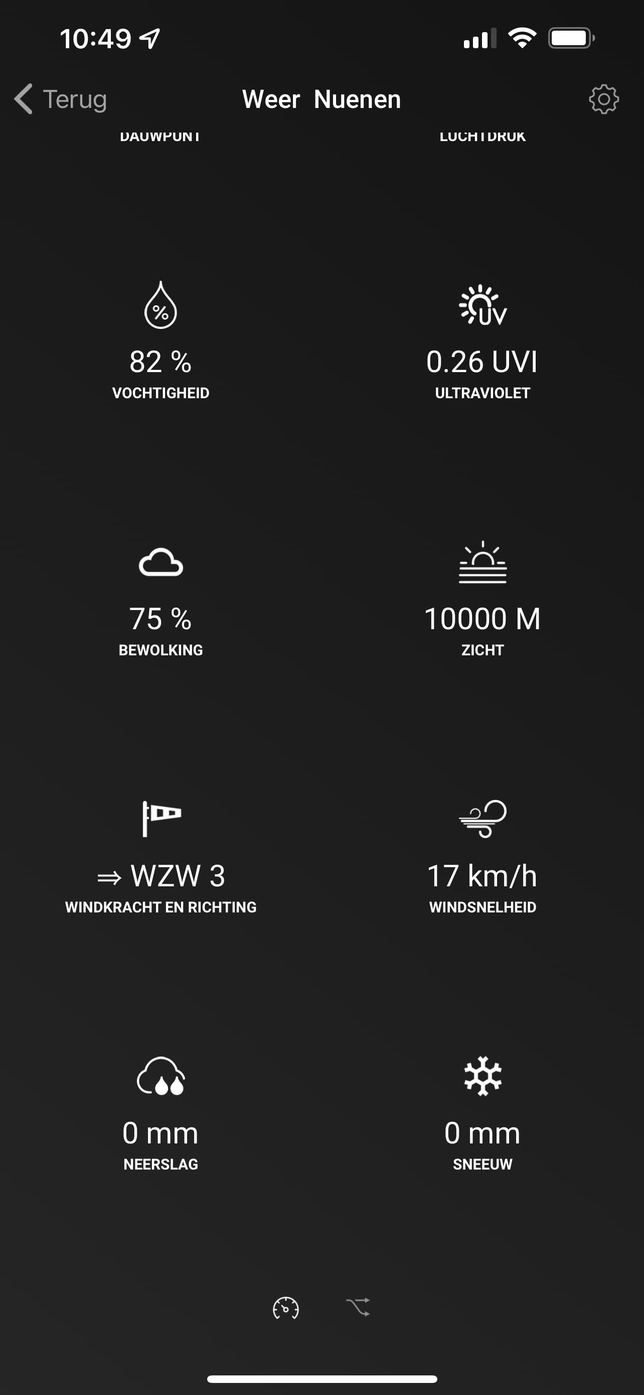

Hi Ronny,
Do you have any idea why since a few days the amount of rain is not visible in the app anymore?
If I look to the current situation for today via an other app (Own Weather station: Rain 7mm):
The information in the OpenWeather app for rain is 0mm:
Hi Rob,
I think the app is providing all data sent by OWM.
As written above, the rain measure of the current weather device is representing the rain of the last hour, not the upcoming rain.
grafik
I checked the API and I can see the API values in the Homey devices.
If you want to know if it will rain today or if now rais is predicted, you could better use the forecast for now/today. Add a forecast device with hours=0 or days=0 to get the prediction of current hour or current day. I think that’s more what you want?
