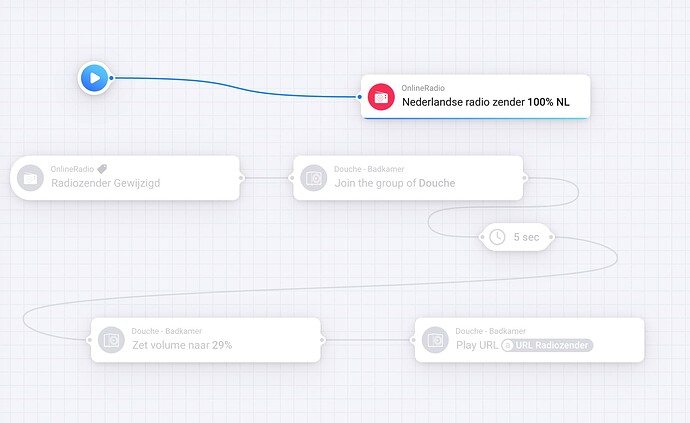

Your first card is also wrong. Salon join salon is not possible. 2nd speaker must join group salon

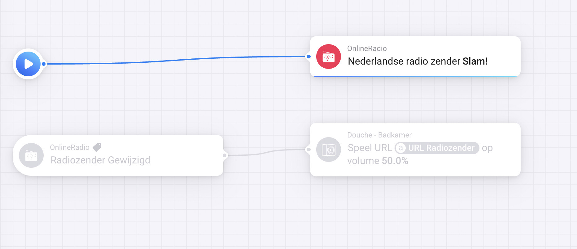

Dear ,
I am trying a little, but am at an obstacle. I am doing something wrong but can’t see it, what ?
  • if I press the first blue start the radio plays
  • if I press the second start the radio station does not play, is the same URL as first start button https://radio-nostalgia.nl/nostalgia.m3u
  • if i press the third start the radio station plays but is dab via Tuneln station
  • stop works well , have taken a flow, daat I did not find 2 size that top push button.
Many thanks.
apologies for my English
Translated with DeepL Translate: The world's most accurate translator (free version)
Unfortunately, this is not how it works. Use 1 trigger flow. And in that trigger flow place the right token in your cast device. Every time you change a station in the action card, it will trigger the other flow.

heeft u enig idee waarom deze flow niet werkt
Wellicht de group kaart. Waarom group joinen voor de zelfde speaker?
Geen idee dit is flow die ik gevonden had op het topic. heb al meerder geprobeerd krijg het helaas niet werkend. hij pakt hem niet over vanaf (radio zonder gewijzigd) URL hoeft niks aangedaan te worden ? behalve url radiozender in play url te zetten zoals op screenshot hieronder
