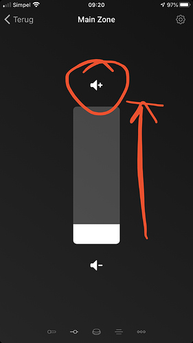

Hi @Mickel_Luiten
When I hit this ‘+’ our cat is in the curtains as the volume directly goes to max. (75!) instead of +1 or +0.5
Is it possible to change that?
I think that is by design by athom since it’s the same functionality regarding of if it’s a dimmer, chromecast ect.
So time for a redesign?! #UX #UI
