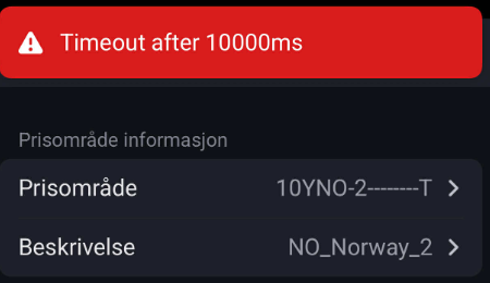

PBTH is actually delivering correct hourly prices as of now. :ok_hand:
Except, it is not possible to set advanced settings at the moment
