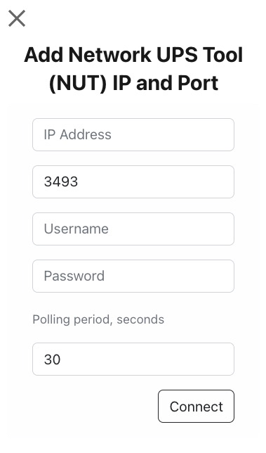

Hi Christian, thanks for your work on this app. I currently run it on Homey 2019, and when I try to add my nut servers, i encounter the following error “Invalid setting type! Got string but expected number (number) for interval” (as you can see in below picture) :
This is strange because i just use the normal input for pairing (I let the default 30 and the problem occurs, and even if I type in 10, or just 1 I got the same error)
