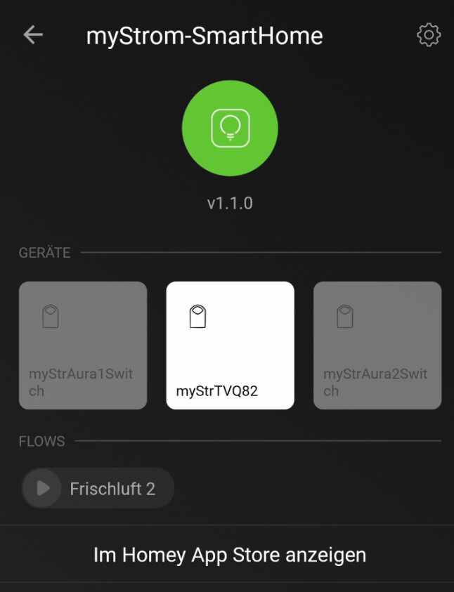

Point Three: At the bottom left of the ios homey app you will find 3 dots labeled “More” press them. There again all installed apps are listed. Press on the “myStrom-SmartHome” app and there you will find all installed devices.

Please make a printscreen of: Tablet > Homey.app > more > App > MyStrom app.
