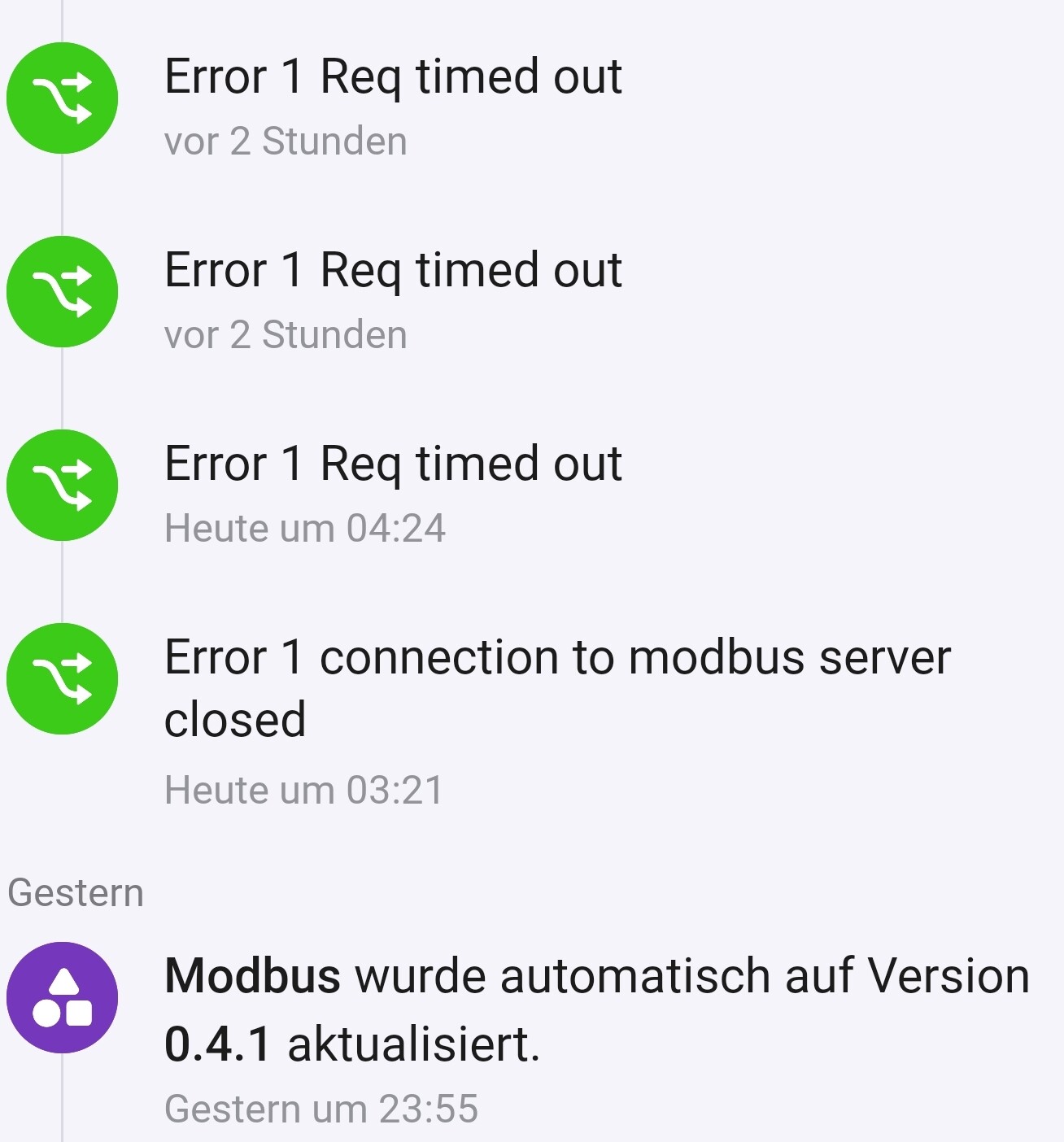

So let’s hope your Homey and inverter are best friends now :smile:
Ok there have been some connection problems but a restart of the Modbus App wasn’t nessesary.
3* request timeout once connection closed
So I would say your wonderful App now even manages to work with the most complicated brand. Thank you so much for optimization of your app again and again. I am so happy now.

After last update get failed reads from time to time. It works after a retry usually.
maybe it helps:
425b37f7-f5df-45d7-9f67-09be1b67e946
I can only see log lines since 8:00 with some reconnects. No errors.
Perhaps I will revert the timeout settings to default.
I have no problems with it. I did something like this to avoid alerts every time it fails.
I just wanted to let you know it happens.
Edit: Do you know how to do this easier?
What error do you get? A simple timeout?
Yup.
error is from another flow
Thanks, then I will change the timeout again. Strange that >3sec are too short to get date.

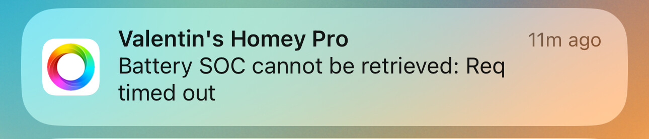

Update for everyone using this App: First of all, after all of App Adjustments of @RonnyW the modbus app doesn’t crash any more when the Huawei S-Dongle closes connection or delays answer. Second: You have to ask your provider to remotely update the S-Dongle and Inverter operating system Since I asked my provider to do so, there are no closed connections or time-out messages any more and Huawei is now working smooth! SO everyone should first update his inverters and S-dongels.
it worked OK before 0.5.0. How is this the S-Dongle fault? :joy:

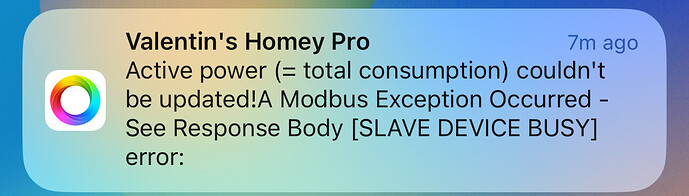

Sometimes I see that I get this:
Yes this error code means that the communication between S-Dongle and inverter is not working. Since mY update of sdongle and inverter I have no errors any more. Not a single one!!!
I think everyone should update their S-Dongle and inverters first! I have the most complicated system with two inverters, S dongle and battery and smart meter… After update of all components there is not one single time out any more!!! Ronny just keep your app like it is! Don’t blow it up too much. I even got a specialist of Huawei: he told me there have been problems with Huawei, therefore an update is nessesary. Everyone can update by themselves or the provider can do it from distance
