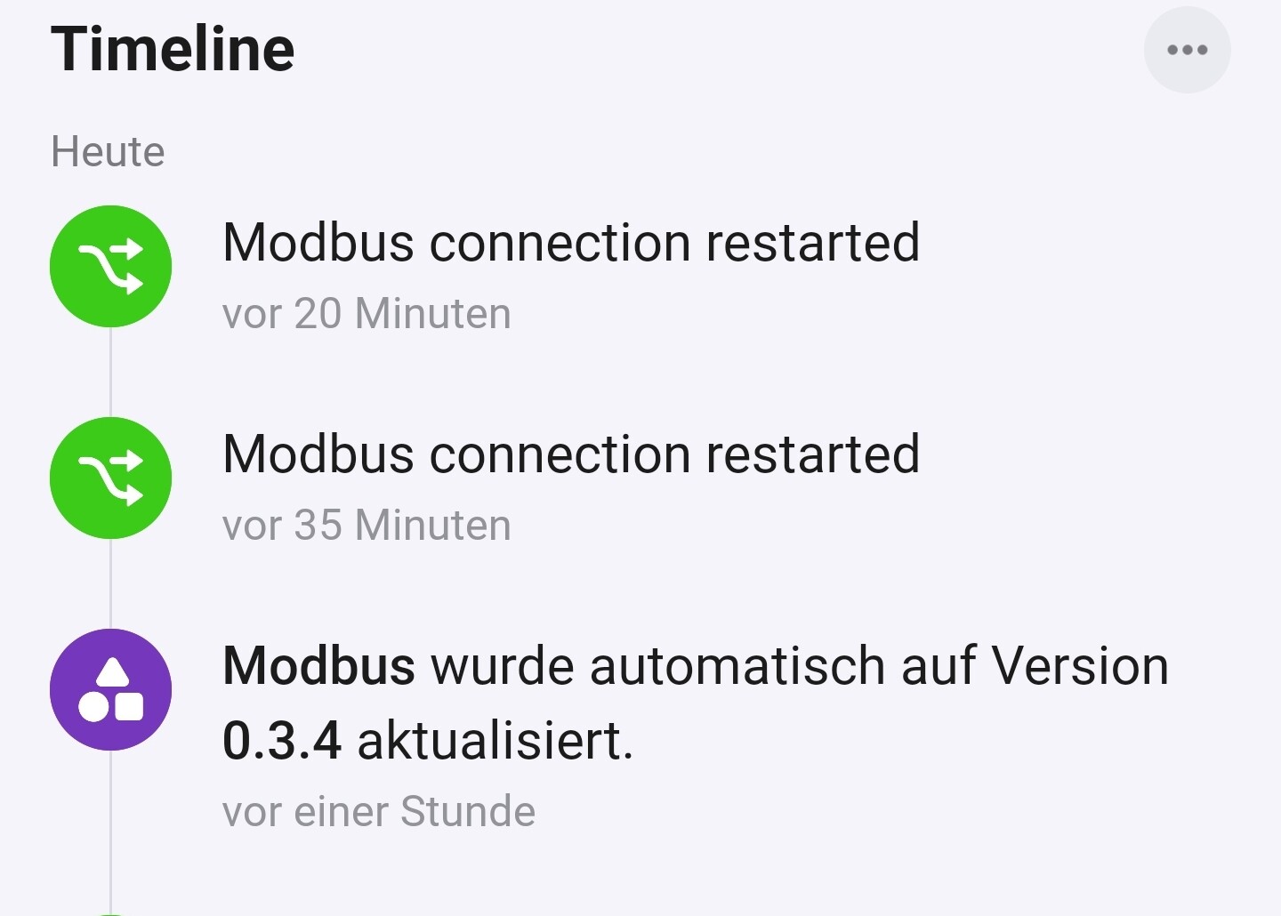

Unfortunately I have still to restart the app… Ok it’s done by the flow when there is an error message.
Here is the error report code
0dbb9264-1809-40ff-b837-08dc48944dc7
I can see a request timeout. It seems the Dongle is offline or doesn’t respond.
Then I can see app restarts.
And it seems there are some run conditions causing errors…
  • a register is read during a reconnect.
  • perhaps reading the register triggers the dongle to close the connection
  • in this case, the connection is closed by the dongle causing the error
  • the app reconnects and than all is ok again.
So I think you should not restart the app onlynif there is one reading error. That can still happen also on network timeout or if the inverter starts/restarts. So just ignore this single tmeout and let read again with the next flow trigger.
Or add a 2sec delay and read again.

had to do this , sdongle is famous for request timeout. now it is almost stable. plus you need to wait a few sec after the connection and don’t do overlap and some time between requests.
    let client = new Modbus.client.TCP(socket, unitID, 3500);
Many thanks. I will add the timeout.
@Sasan_Khandanpour:
Like Edmin said, please make serial requests to your inverter in your flow and not parallel. I hope this prevents most timeouts.
@CaptainVoni:
You asked for INT64 values. Is this still needed? Has your inverter really 64bit values?
How is the register defined and what is set in the flow card?
Hi @RonnyW , hi @Edwin_Biemond ,
thanx for your good ideas. I already had set up all requests in serial order. But I don’t know what you have changed since 7:42 am?!? Since 7:42 I had no error and crashes of the modbus app any more. Since then it works smooth, even in my complicated two inverter Setup (18,6 kwpeak, heat pump 15 kw battery). have you changed the programmation? Ok I can’t trust in that peace… let’s wait till tomorow.
