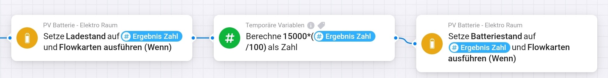

For battery time out: I have the same problem. The battery doesn’t have it’s own ID. I don’t know how to get the data from battery itself. But you can ask the sdongle for SOC. Just set up S-Dongle as Modbus master device with ID 100. After that you set up Modbus device as slave with the id of the inverter who is connected to the battery. Than you have to set up a flow to the inverter with adress 37004 with size 1 and type uint16 and #0.

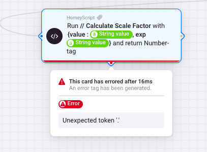

Here is my first attempt. I have written the Homey Script as per your example:
// Calculate Scale Factor
let json = JSON.parse(args[0]);
let value = Number(json.value);
let exp. = Number(json.exp);
return parseInt(value * Math.pow(10, exp));
Here is the Flow:
And here is the error message I get when I test the Homeyscript:
Screenshot 2024-03-18 at 4.40.09 pm
Could this be because of the test data I entered. I entered -2 and 10000.
No, you have an invalid JSON as argument.
{ value: -2, exp 10000 }
Should be:
{ value: -2, exp: 10000 }
You are missing a colon.
And in your code remove the point ( . ) after the “exp” variable name:
let exp. = → let exp =
