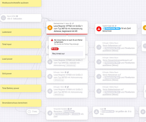

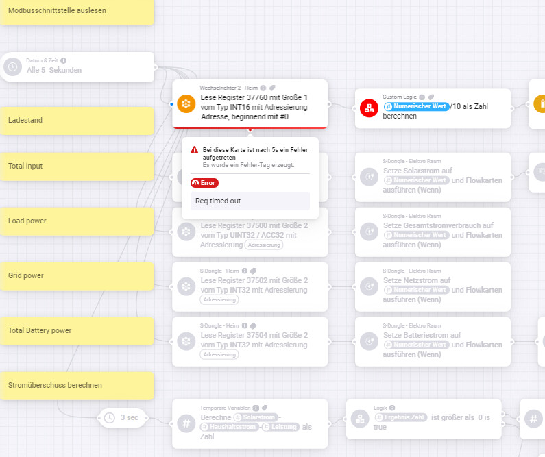

thanx for changing. Once after installation of all 3 IDs and changing to single connection, I could one time read out ID2 (this was unable at the old version). Since this one time succesfull connection, unfortunately the whole meodbus app doesn’t work any more. Now I get everytime at any ID the error code “req time out”.
So I am sorry. I used it in this flow:
Even when I choose manual mode with this flow only, it is still not working. I mean it worked for one connection (in the old verison it didn’t work at all). I was first so mega happy, but since the second try, nothing works any more.
