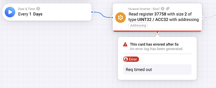

Hi my friend. I just now read your answer. Meanwhile I tried this out:
If I reconnect (Verbinde Gerät) the running ID again and again it works. But it works only in manual mode. So its not optimal and not smooth or elegant BUT it works.
Lets try your suggestion. I make an ongoing flow without reconnecting after two flow cards and than I send you a diagnostic report.

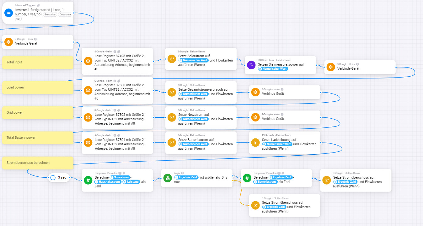

I have also a Huawei system with dongle and two inverters and a battery. Ronny’s app works great on it. You make first master connection with the dongle (in most Huawei systems it’s ID 100). Than you have to connect as slave with your inverters (in my case ID 1 and 2). The battery is connected with one of the inverters, in my case with ID 2, therefore it’s not nessesary to connect the Modbus app with the battery. Later I will send you my flow with all registers (by editing this reply) .
Hi Valentin,
I had the same problem, but with me it lost connection after hours. thats how I did it:
First set up / installation of modbus IDs:
First install as Modbus-Gerät the Huawei S-Dongle (IP number in your privat LAN/Network) with Port 502 and with ID 100.
Than Go to the modul and chose with right mouse click “Einstellungen” (setup?)
There you have to Chose Verbindungstyp as Manuell.

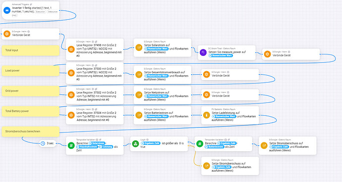

Than I used this Flow:
For the very first start you need to manually start the flow From Verbinde Gerät to initiate first connection.
I used the app device capabilitys as virtual module to save and display the results.
The results from S-Dongle they are only updated each 3 minutes, so a shorter delay doesn’t make sense. In fact, maybe thera aren’t nessesary at all when you measure them with a smart meter by yourselve, like I did.
In my flow the value #Haushaltsstrom measures the electricity usage in Watt of my House and #Leistung measures my heat pump. So in fact I only need Input of the inverters to calculate the Solar production (directly from Inverter ID1 and ID2) and from S-Dongle I only need the charge/discharge power of the battery. Unfortunately I can’t read the adresses from the battery directly.
