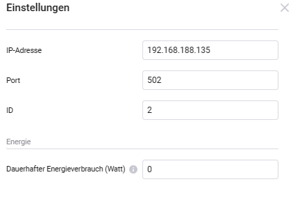

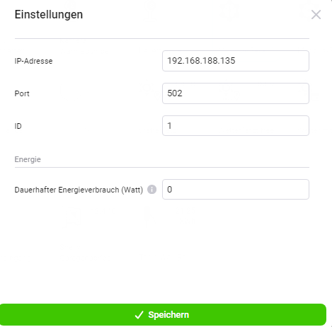

Thats how I installed the two Modbus devices:
Modbus 1 settings:
Modbus 2 settings:
The ID 1 is the Huawei Sun2000 8KTM Inverter and ID 2 is the 10 kw inverter:
I checked this IDs in the settings.
But since I have installed the second Modbus Device it doesn’t work any more!

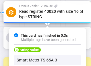

Every device has it’s own context/settings and independent connection to the target device.
As said I tried two device IDs and it’s working:
grafik
Inverter:
grafik
Electricity meter
grafik
I get the correct device name from the registers.
grafik
grafik
So the app is working correctly :man_shrugging:
