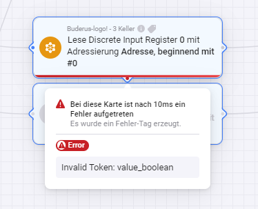

Hi Ronny,
reading DiscreteInput is not working.
InvalidToken_value_boolean
i changed
                case 'BOOL':
                    valueBoolean = res[0];
                    break;
to
                case 'BOOL':
                    valueBoolean = res.response.body.valuesAsArray[0] == 1;
                    break;
in device.js and at least for my usecase (reading digital inputs of Siemens LOGO!) it’s fine now.
